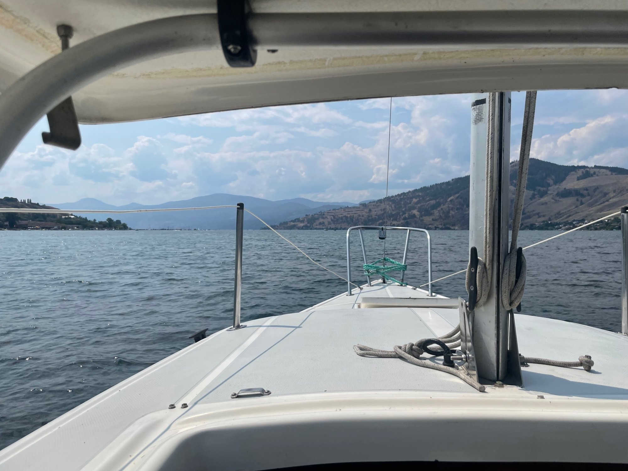

It might help if you could post a photo of the base of your mast where the vang is going to go. Using a block and tackle with a boom bail is nothing new, but you will want a strong attachment at the mast. You could lash a shackle there, but the lashing might interfere with other things - thus the need for a photo.

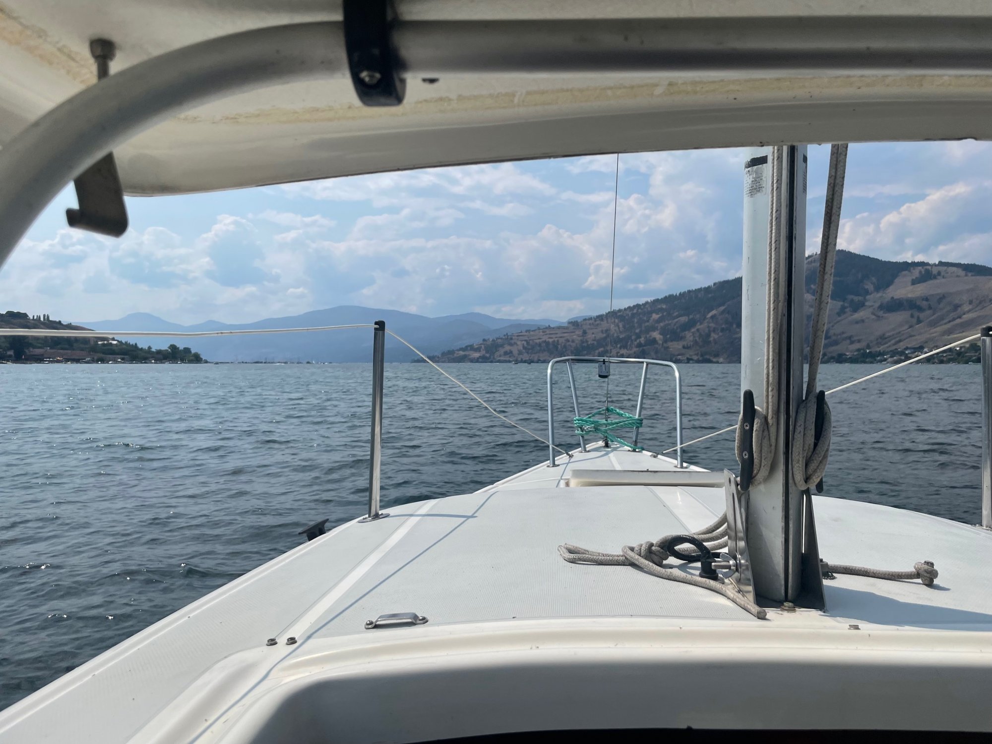

I’ll post a picture of the base with the mast unstepped. I’ll look at the kit too. I do like the idea of a bail at each end. Would you want to drill and install a thru bolt right through the mast and boom or? I would be concerned about rounding the holes out, making them larger.
The Mac is very lightly rigged. The only thing at the bottom of the mast is the neatly stored halyards.

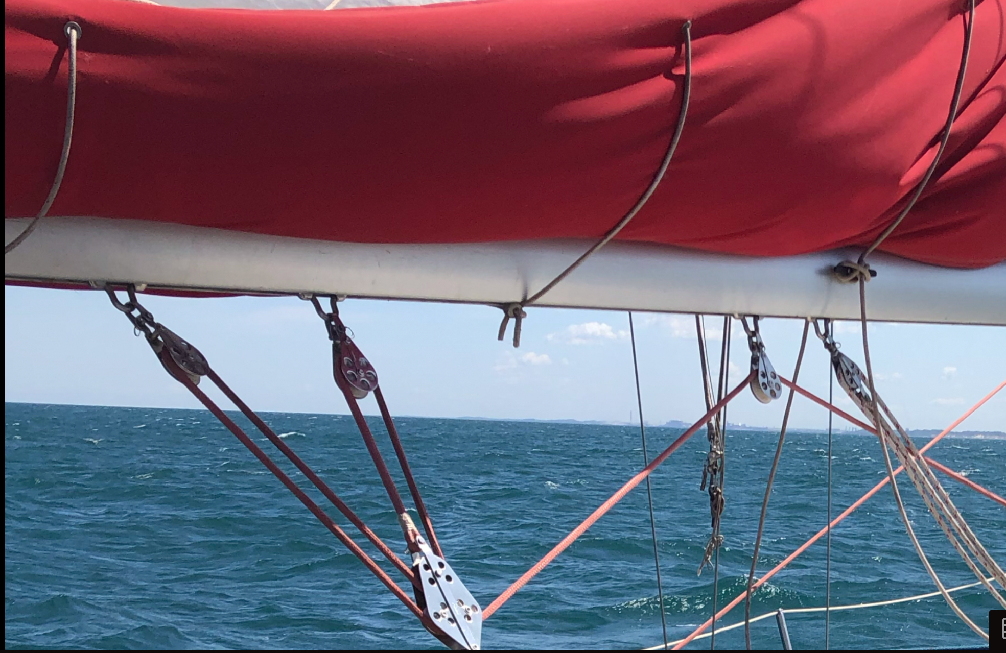

I originally had a rope vang on my O’Day 322…you can see the top end in this photo…
Sorry, I don’t have a photo of the bottom of the vang.

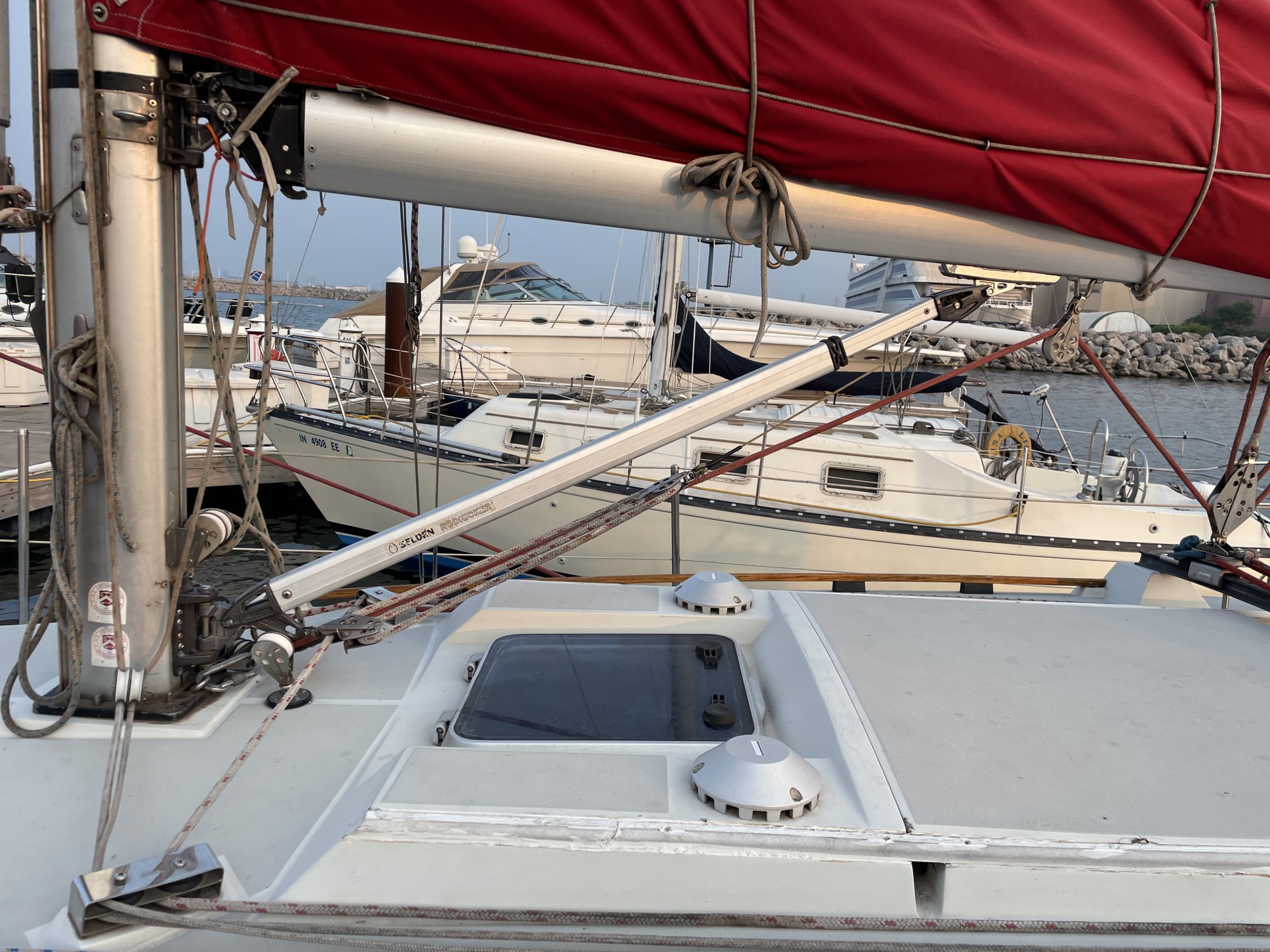

i later replaced the rope vang with a Seldon rigid vang…

I can see the plate, that's a good idea. Wouldn't know which one to order :)
I found this picture.
If that's the base of your mast in the photo, the simplest solution would be to use the bolt that holds the mast in place to also hold a bail for your vang. No need to mess with putting another hole in the mast. If that doesn't appeal there must be some sort of padeye that comes on a slider thet will go down the slot at the aft side of the mast and then get tightened In place there.

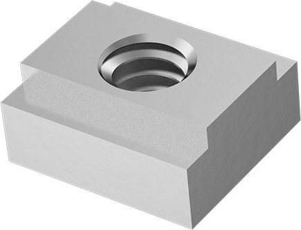

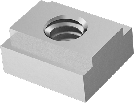

You can also get a padeye like this one.
And either drill and tap, or use a couple stainless t-slot nuts in the boltrope track.
