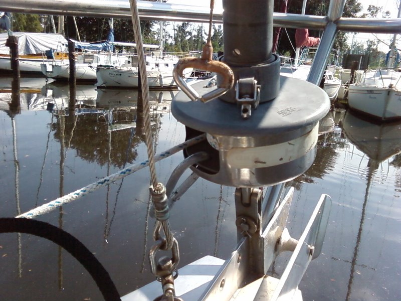

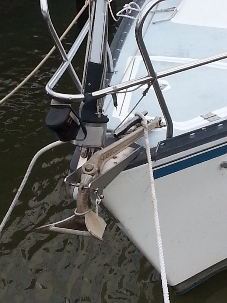

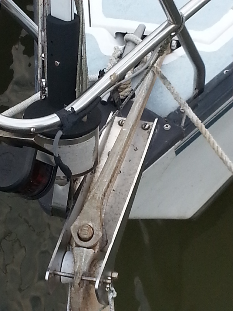

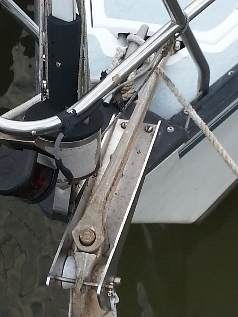

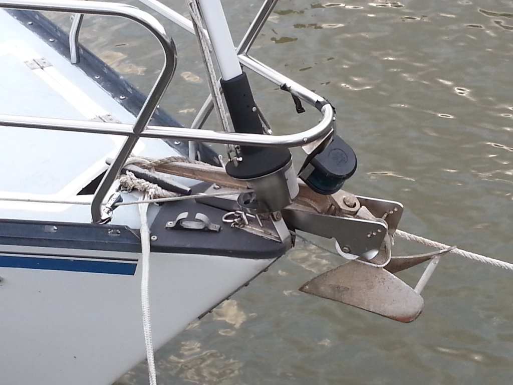

Here are some of another H-27 that I took for reference. I'm assuming it's through-bolted with washers or a plate underneath in the V-berth.
