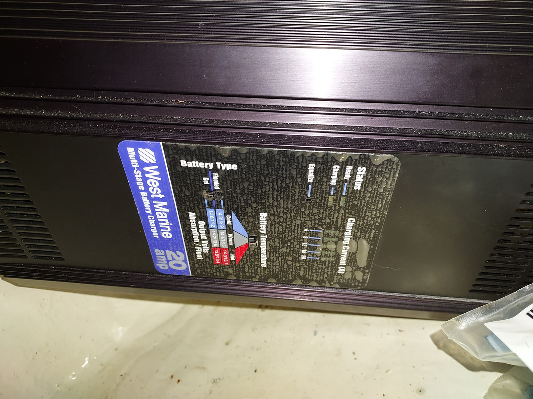

I would like to clarify I did use the term shopping not buying from west marine. The charger I am replacing is the one below.
So I went to west marine to see if they had a bolt in (in this case screw in) replacement. Unfortunately they do not.
