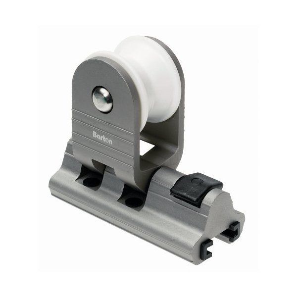

Yes. It makes singlehandling a breeze. I have an autopilot but when I Tack or Jibe I don't use it anymore;well, as much.
The other thing I did, was to use the existing genoa cars. The problem with using just the snatch block is the genoa sheet rubbed against the life line with the sail deployed.
Ideally it would be nice to replace the cars with ones that have more sideward movement. see attached picture.

Not Quite.
The Sheet runs from the Genoa thru the car, then thru a snatch block (located on the toe rail) and up to the winch.
I found that under sail, the Genoa sits outboard of the life lines if I only use the snatch block. This made the sheet rub against the life line while sailing. Also the slot between the Main and Genoa was wider than when using the car.
It works well but it would be nice if the car swiveled sideways more. I'm not going to change the cars unless I can find a used pair for a cheap price.
