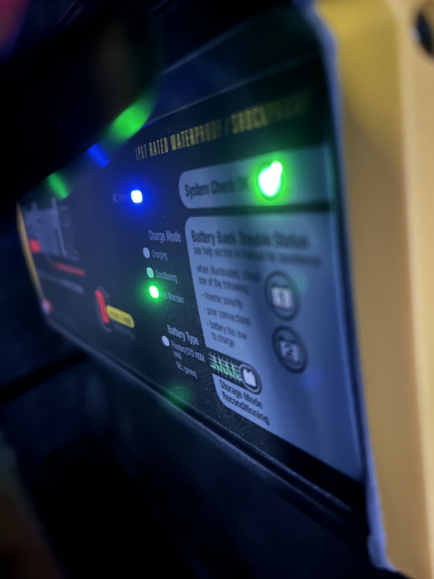

Does anyone think it odd that the battery charger appears to be on (indicator is glowing) but the battery voltage meter is only reading about 12.5 volts?
Yes, it does seem odd. I wonder if there is explanation ....
Thanks Richard19068 and Scott T-Bird. The meter on the top left is for the 12 volt system. There is a meter on the right for the 120. jssailem has my pattern down--day sailing for at most 4 to 5 hours in the Winter months, two or three days a week if I can. An expensive electrical monitor is probably overkill for my current needs. If I have any issues, I will add a starting battery before I go on any overnight voyages. I decided to start by replacing only the older of the two batteries. The one dated 8/19 seems to be ok. It works (short term) fine when I select only it from my battery switch. So I replaced the old looking battery with no date with an Interstate dc 27 that I got from Costco for $99.65 with core after tax. I don't think it was much of a gamble, mostly my time--and I got to practice my "boat yoga" for about 20 minutes. The Costco batteries are not fully charged. I replaced the battery just before nightfall. It has been charging overnight and I plan to go sailing today. I will let you all know.
What Richard19608 noticed is your 12 volt meter is showing 12.7 volts while your charger is turned on. Battery chargers charge at a higher voltage, usually around 13.6 volts. A fully charged battery, when sitting at rest for a few hours after being charged will show 12.7 volts.
The voltmeter may be indicating that the charger is not working, something for you to check. It may also be due to voltage drop due to a poor connection.
Try turning off the battery charger and note the volt reading. Then again with the charger on and once again with the charger off and motor running. You should see an increase in voltage with either charging source on. If not, the charging voltage is not reaching the batteries or they have failed.

@acudavid , if you have a multimeter, put it on the battery posts while it is charging (and resting). Perhaps your meter is off. @Ward H is right about the voltage in float mode at 13.6 (which is what we would assume at this stage). In bulk charging mode (when your battery is drained and you just start charging) you should probably see about 14.3 volts. What Richard's keen eyes were picking up is that your battery voltage seems too low for a charging battery. If you don't have a multimeter, it would be handy to get one.

If the charger is on it should be able to keep up with a load like a stereo and stay around 13.3 volts. Some chargers have a California compliance mode where they basically stop charging shortly after the battery is full. That’s not necessarily the most battery friendly but it could explain the voltage reading.
Now that you have two dissimilar batteries I’d recommend only having the 1-2-B switch on both when you’re actively charging. Discharging while on both is not ideal. Of course that leaves you in a position of choosing to sail while using the old weak battery and saving the good one to start the engine, or sailing with the strong battery and risking draining it too far and needing to try to start with the weak battery. Neither case is really great, so if it were me I’d probably replace the other old battery and keep an emergency jump pack just in case.

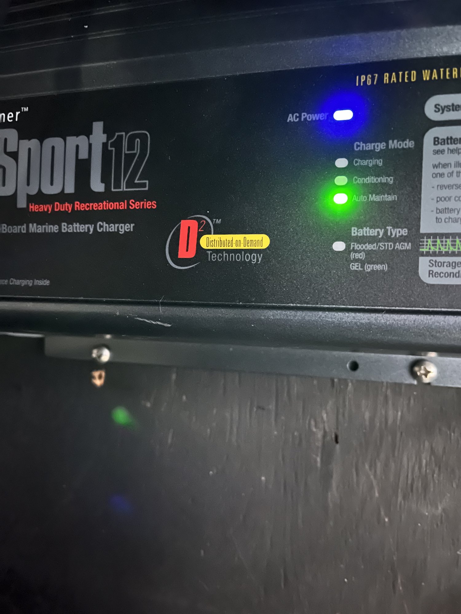

I am wondering about the charging. The 12 volt meter reads 13.5 in the am after being plugged into the shore power all night. Then when I disconnect, start the motor, it goes down to 12.8. This is for the "1+2", the "1", and the "2" reading. After about about 5 minutes, it still reads 12.8. I don't know if this is normal.
It is difficult to see the charger. I will have to take the internal port cover off to get a chance to read it. If I need to, I will get the model number.
If the readings sliding down to 12.8 are not normal, than I will take pics of the charger. As of now, the motor fires up much better than before.

What you are describing is pretty normal. The 13.5 voltage is the float voltage. It is a low current stage that just keeps the batteries topped off and compensates for the battery's self-discharge rate and any small loads.
12.8 v is a pretty typical voltage for a new battery that is fully charged after a few hours off of the battery charger. When a charger is disconnected, the battery voltage will remain high (~13+v) for up to 24 hours, before settling down to its normal voltage level.
When you get a chance take a photo of the charger. It is probably one you will want to replace. Modern chargers are kinder to the battery which encourages longer battery life.

I was able to take some pics. The charger looks newish. It is a ProMariner ProSport12, which seems to be the 3rd generation. The 4th generation--called ProSportHD12-- is widely available, and Amazon still has one vendor selling the ProSport12. I can't see any identifying numbers on the front and it is mounted securly. I don't know if the brand is good, but it seems to be working.
The prior owner spent nearly a thousand dollars updating the electrical system onboard. The electrical panel that has the meters was replaced. The receipt is cryptic to read, and there are no line items, but I would not be surprised if the charger is about 2 years old. Please let me know any thoughts or advice.
