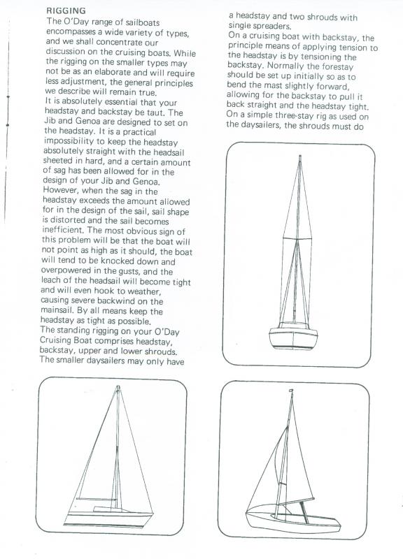

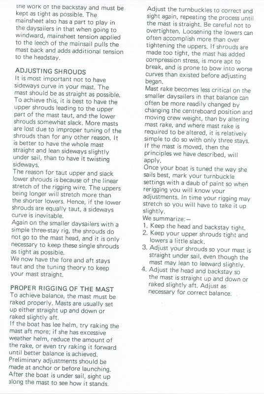

Unless you are a competive racer, it really isn't critical to tension hte rigging to any set pounds. Basically, the 240 should be set up similar to the 25 and here is the manual advice: "After all stays are securely attached, take the slack out of the rigging and tighten. With the mast plumb (in a vertical position), the Headstay, Backstay, the two upper Sidestays, should be tightened 3-5 turns more than hand tight. The two lower Sidestays should be just taut, not hand tight."
The General Rigging advice that came with most O'DAYs is scanned below.

Can you scan again? All I get when I open is first 2 columns, no pictures, and columns 3/4 are non existant. Also so small I can't read it...

Elegant, simple, informative. Thanks sunbird!
