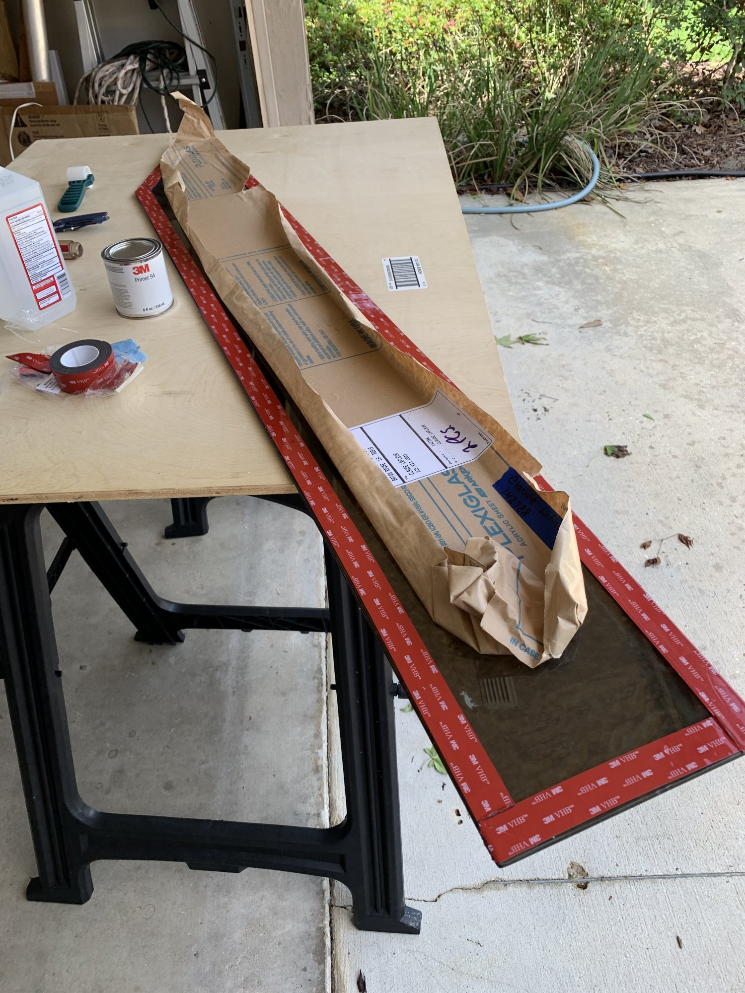

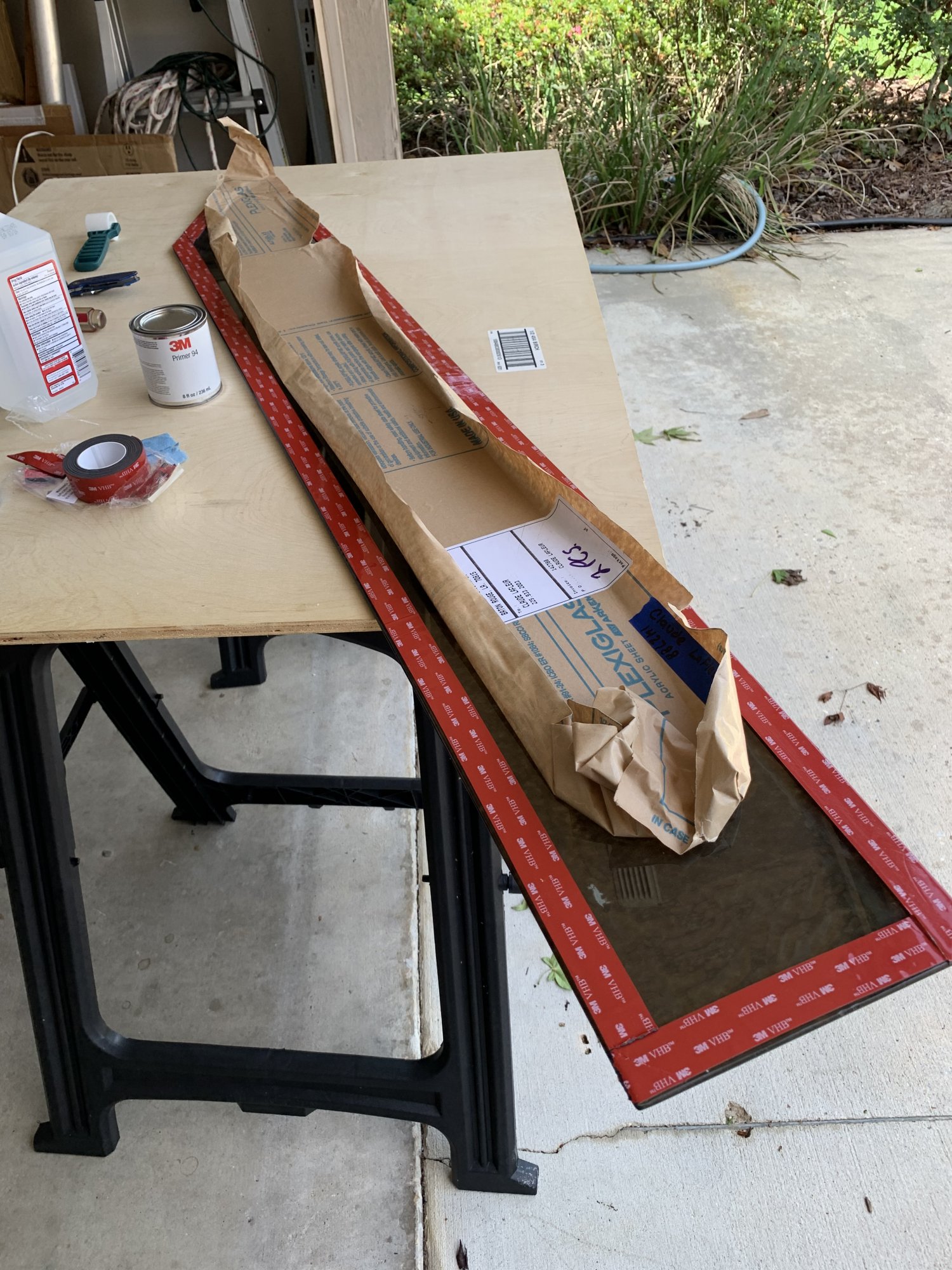

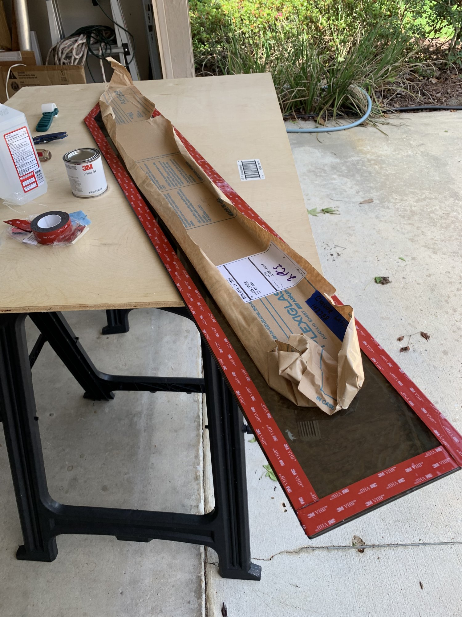

Here is the straight poop on the VHB. If you can easily hold the plexi in place to keep it curved, the tape alone probably will hold it after it has cured for a day. I was advised to use their primer on the cabin side as well as on the plexi. My plexi is slightly curved and it was no problem to get it bonded. It is critical to get a good force on the bond area immediately at installation.. I used a wallpaper seam roller. If nervous, you can use a couple of screws fore and aft to hold it until it fully cures (72 hours). Then remove the screws and plug with Dow 795..

XAVPIL, I used 3M #94 primer, available from Amazon and some other places. I didn't know how much I'd need so I bought a pint .. It only took about 4 ounces for the job. I bought the 3/8 plexi from a local plastics supply here in Baton Rouge. they cut it to size. When I did my hatch lenses, I bought the plexi from Tap Plastics in Stockton, Ca. They cut it and radiused the corners exactly to my measurements.

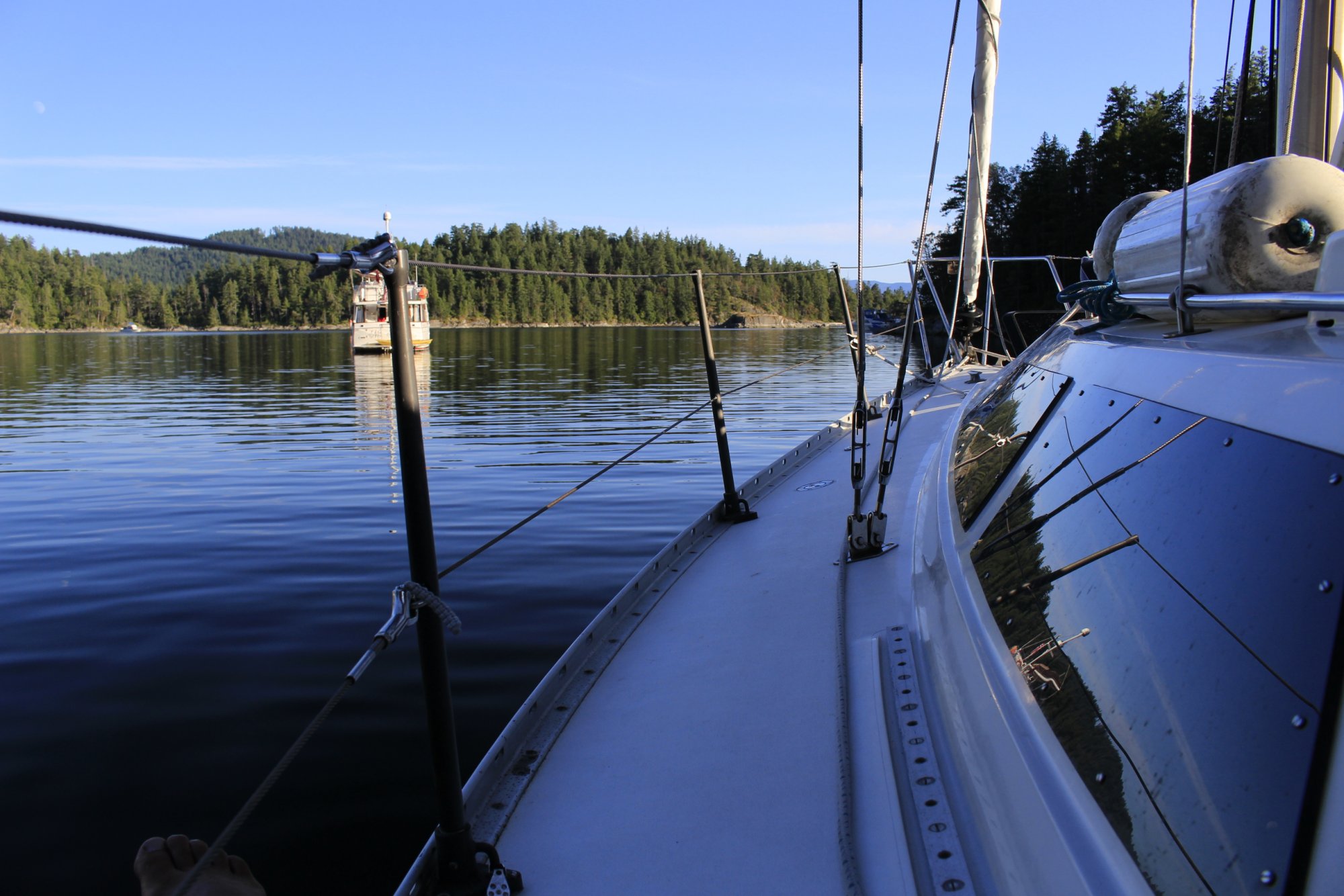

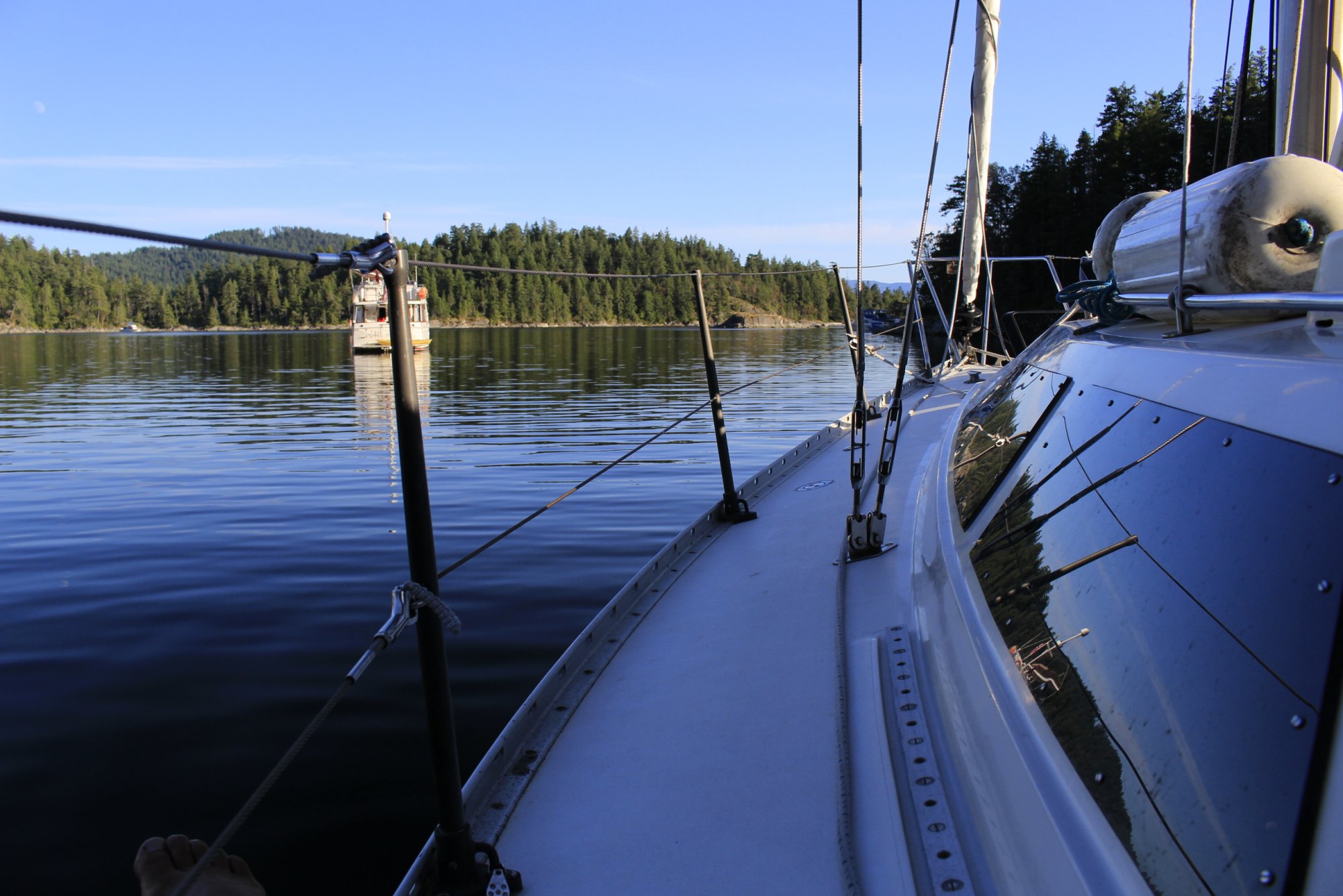

Another endorsement for DC 795 (sometimes labeled Dowsil) when you buy it check the 'best before 'date. Limited shelf life
Although I used screws (pre existing windows were screwed on) you can see it managed curvature and twist... sealed with DC 795
Likes: xavpil
it looks GREAT!!!!!
