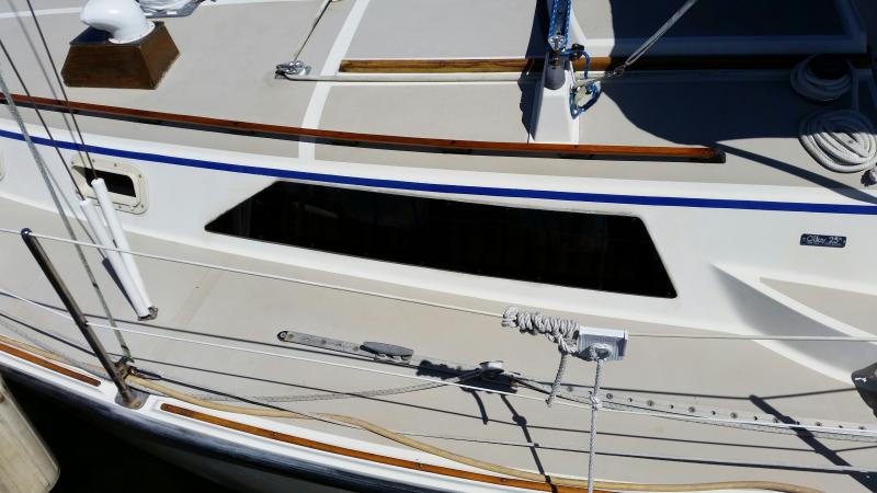

I was horrified to find a top to bottom crack in my cabin window a few days ago. There were a few additional cracks in the corners around the screws, probably over-tightened.
I had read a lot about going with an adhesive only installation and foregoing the screws. I figured the screws, washers, and holes were already there, so as they say,, SCREW IT!
I found a local custom plastics shop that would cut a new window, using the old window as a template, for size, shape, color, and screw holes.
It was suggested I use LifeSeal as an adhesive to the cabin frame, and as a bead as a caulk to seal the new window.
It came out GREAT! Had the screws and washers painted flat black, so they are barely visible,,, a more updated look,, for $70,,

Looks great! When I replaced my acrylic portlights in my 272, I learned the screws were only there to keep the acrylic in place while the Dow adhesive / sealant cured. Once the sealant is cured, the screws are superfluous. In fact, because the acrylic expands and contracts in cold and heat, the screws may cause cracks if they are over-tightened. Look at your acrylic from a low angle in the light. If you see the surface bend around the screws, they should be loosened. I over-drilled my screw holes, so there would be plenty of play, and I checked to be certain there were no over-tightened screws. I left them in because they were painted black and filled the holes. The new acrylic ports look great! I also replaced my opening ports, and they look great too.

I think the secret is using Dow Corning 795 caulk as it will expand and contract...used for car windshields.....the screws don't do much other than hold it in place I guess...I learned the hard way as we used silicone and the windows we bought from Rudy cracked with the first hard freeze....then I read the instructions.

I asked for a recommendation from the owner of the business that cut the new acrylic window -- he STRONGLY suggested I use LifeSeal, fine,,,
as he stated, some products will actually "digest" the acrylic material
I had no issues or complaints about the use of LifeSeal during the installation process,,
so far no problem,,,
time will tell!

If you decide just to use the dow 795 and not screw it down, how do you hold the window in place while the 795 cures?

We did put the screws back in just to hold it in place while curing but I can't see any reason to remove them now after two years.....it would just show the screw holes we had drilled in the new portlight.
First use 3m vhb tape 1/8 thick that will both hold the pane in place and give the proper thickness to the 795 seal.
Second you can use wood shims to also hold it against gravity if you like.
I posted pics here, a search will show them.
With careful masking it came out well.
