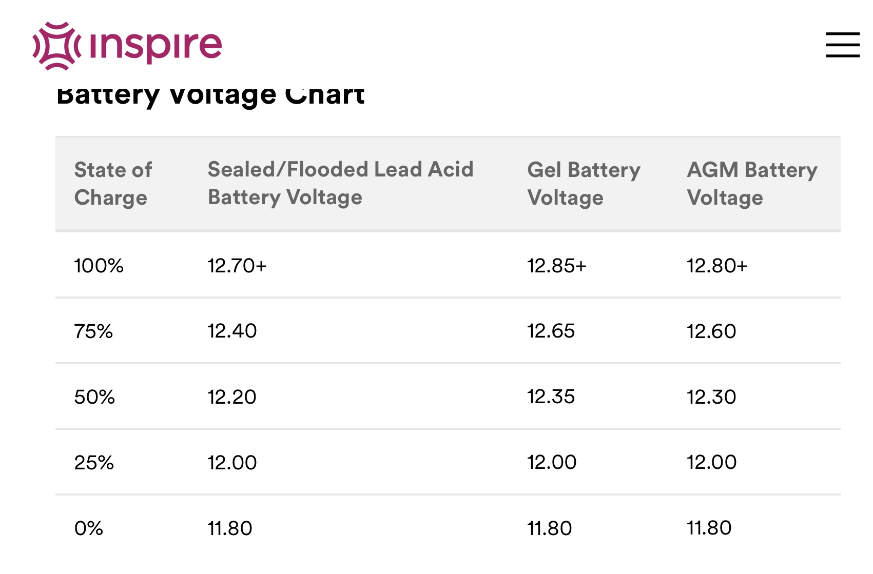

You need accurate readings to be able to assess if your ACR is functional. A Digital Volt Meter is used. Apply to battery terminals after the battery has charged and rested to test.
You need clarity in the way your system is wired. What is the charging source? How is it wired? Where is the ACR in the wired system? Did a previous owner wire it or was a Marine Electrician used?
Is the battery new or is it long in the tooth?
Here is a rough guide to state of charge
