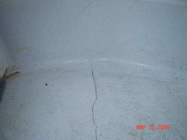

I'm looking for advice on the best way to repair a long crack in the bow storage area in my 170. It extends sideways across the entire bottom and, as shown by the photos, has significient displacement on the port side.
I believe there are several possibilities for repair...
1) Remove a 3-4 inch strip the length of the crack and repair with epoxy/fiberglass in accordance with some of the ACP repair guides discussed in this forum
2) Remove the entire bottom of the bow storage area and repair with fiberglass
3) Reduce the displaced crack, seal with Devcon Plastic Welder followed by fiberglassing the entire floor for added strength
The crack probably happened when I was standing in the area. I want to be able to load this area in the future without worry so I'm leaning toward option number 3.
Any comments or suggestions? Thanks...
