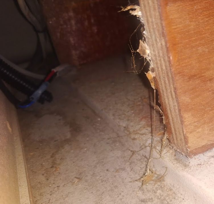

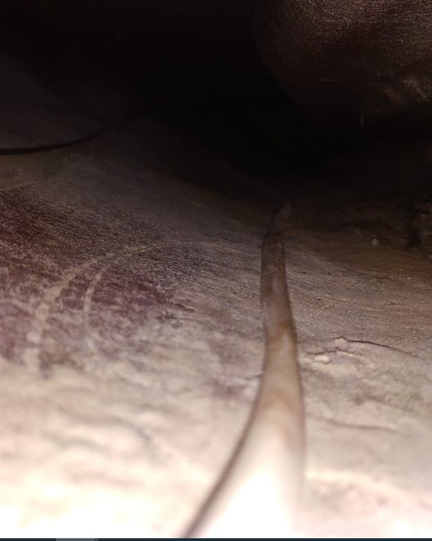

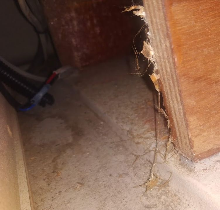

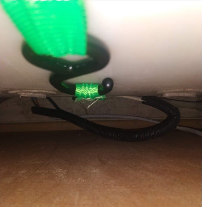

On a 2000 Hunter 340, I have sudden losses of water from the freshwater tank in the V-berth - meaning that with the pump off, I might lose 1/4 of tank overnight. Then it may go down steadily from there. If I need to repair or replace the hose from the tank, how is this even possible? There's no space between the built-in shelving that is wedged into the fiberglass. There's a little panel on the right-side lower cubby - the only access. There's just no way I can see to get to the hose. After an extensive investigation with a surveyor, there is no leak under the tank, but I want to check this hose. There is no leak after the pump. (I'm putting aside the bilge for the moment - it does fill within about an hour, but since I'm putting a bag of ice in the "fridge" everyday - that would explain it. Also the keel maybe weeping.)
The three pictures show:
1. The exit from the v-berth running under the settee to the pump (dry)
2. The dry bottom under the tank with the hose going under the compartment to come out under the settee. (I was able to take this photo from the bottom right cubby after removing the panel.
3. Looking directly down at the hose as it exits the tank (appears dry). This space is about 2, maybe 3, inches with the tank pushed all the way to the bow. The green strap is a tie-down I inserted (with extraordinary effort to replace the original broken tie-down).

On my 2000 340(new to me), I have replaced “all” the freshwater hoses, except that one 3-4 foot length. I want to replace it, not because of a leak, as you described, but because I want to give myself more movement in the line to be able to add a better winterizing access point and change it to match my new 15mm hosing. But I haven‘t attempted it yet. But it ain‘t broke so I don‘t want to fix it.
That being said, at least on mine, you have to remove the cushions from the front V berth, then you should see a lot of screws holding down the floorboards for the bedding cushions. About the same amount of screws you need to remove form the floorboards under the settee cushions to replace the water heater.
This should allow you access to the left side of the tank and see the hosing from the tank to the pump. It’s a deep drop to the hosing but, if your “flexible“ enough it can be reached.
If I’m reading your description right, you got to the spot from the left side access, but I don‘t see any hose line in your 3rd photo. And that‘s a small access point, how did you get in there?
If you can find the leak and hopefully it‘s “after” the tank fitting (it must be if you are saying there is no water at the tank) and in the line, so you can cut the line and add a fitting that transitions the original 1/2 inch line to another size or back to 1/2 inch and continue on from there.
