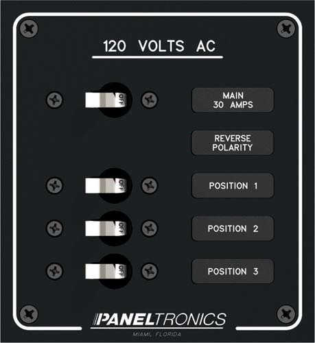

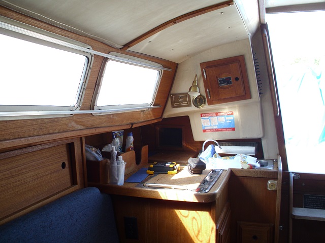

All,
Thanks for the various replies. I did order a new panel with reverse polarity indicator, and reverse polarity disconnect. It has a three section main breaker. Two for the hot and common, and the third that is voltage activated ( I think) so if it senses a reverse polarity, it will trip the main. The panel only has three branch circuits. In my N28-2, the only AC circuits are a few standard receptacles (4 or 5 I think). I plan on wiring the receptacles to one branch, a second branch circuit for the marine battery charger, and a third branch for future expansion. The panel will be mounted in the same place as the original. Just need to open the liner up to fit. I have a small light also mounted on the liner that I may have to move to make enough room. Anyway, here is a picture of the panel I purchased, and where it will be mounted.
