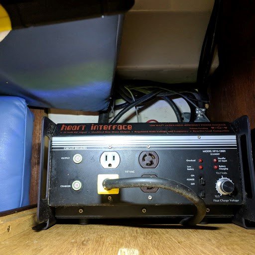

We just purchased a 1984 Hunter 34’. It’s my second Hunter, my first was a 31’ which I so loved. This boat has some added features like a fairly new refrigerator, and AC. The boat did well on the survey (LOL) for which I asked they check the electrical systems. Well, I know there is an issue which did not show up. So, I am looking for suggestions on what is installed and how to remedy the problem with little cost. I have an extensive electronics background in a totally different application, so I can do the work myself properly with some good advice.

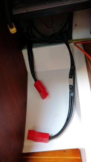

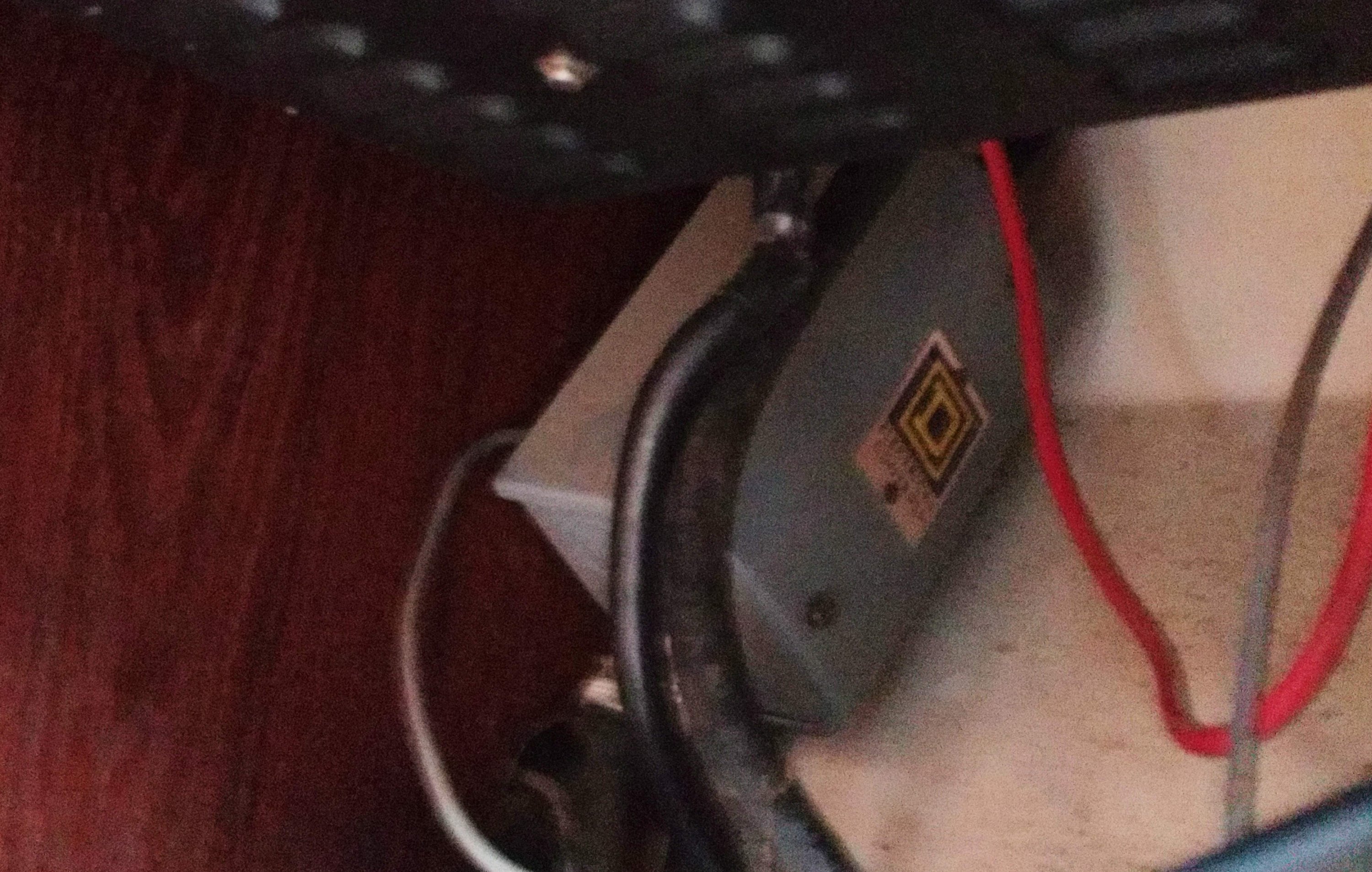

I was checking the electrical loads when I noticed there were some hot wires and know I need to make some changes. I have added three photos: 1 of the old inverter which is hanging upside down under the nav table. Photo 2 is a “Square D” gray box which has a loud hummmmm, and Photo 3 is of the jumpers attached to the inverter. We have only started our refit and repairs and I need your expertise on my electrical situation. The inverter also has a 12v. connector on the floor. The last time I saw a connection like that was jump starting airplanes when I was a kid.

The first thing I'd be curious about is the Square D electrical box. That is obviously not a marine quality box and there is no telling what's inside. I'd open it up. Since a prior owner used shore based electrical products, I'd check all the AC wiring to make sure that is done properly, i.e., stranded AWG wire, no wire nuts, proper circuit protection, etc.

Going to take some wire tracing .. Guessing: the wire plugged into the inverter goes to the 110V panel? so it can be unplugged for shore power..
The big red plug is the 12V supply to the inverter the inverter can be unplugged when not in use..
Humming square D is anybody's guess.. maybe a home made isolation transformer?
