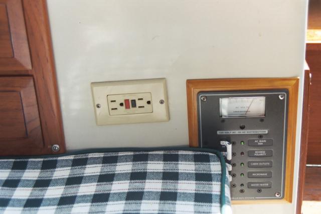

here's the smallest AC power panel with main and three breakers that I could find to replace literally just an on-off switch on my last boat, a 27 footer. The wood trim around it was made from moulding from the HD. Doesn't take all that much space to be safe--don't forget to cover the back side with plastic safety box!

Blue Seas makes breaker AC panels with as few as 2 or 3 circuits including a main breaker.
