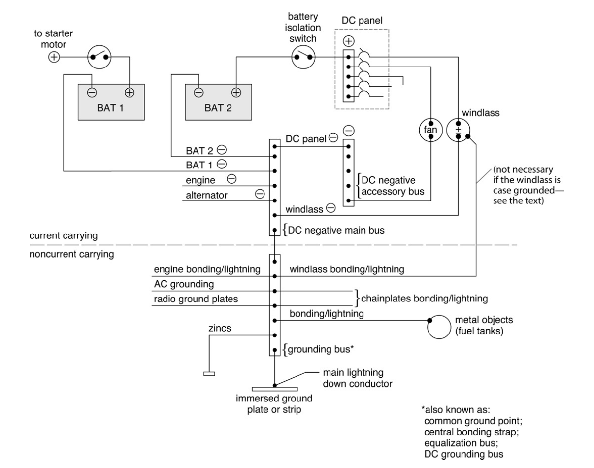

The pathway is through the shield on the coax. The shield is connected to the outer part of the connectors. At the antenna mount the shield is connected to both the antenna and the mount through coax connector. The mount is usually screwed directly to the aluminum mast which is grounded to the keel or the bonding system. At the VHF end the shield is connected to the DC- through the radio circuits. The cure is to isolate the antenna mount from the mast.
I was thinking the same thing, but isn’t the lightning bonding system usually (supposed to be) tied into the DC negative and AC grounding bus somewhere? That’s how Calder shows it anyway.
If that’s the case then the mast would be connected to the boat’s DC negative at some point regardless of whether the VHF was tying the antenna ground to the DC negative.
No bonding system on my boat. My AC is connected to the DC- bus though. I guess the mast could connect through the water via the lead keel/keel bolts? My hull / keel joint was filled and faired last season with all new bottom paint. I guess keel could still find small connections at some spots?
If the AC ground and DC- are not connected to the lightning ground, then that would explain the voltage difference like dlochner said. That would mean that when the antenna is disconnected the zinc is protecting the prop shaft any any other underwater metals connected to the DC- bus. When the antenna is connected then the zinc is protecting those metals, plus the keel and any other underwater metals the rigging connects to. That could increase the rate of zinc usage. The voltage change would be cause by galvanic interaction between your keel and any other underwater metals on other boats around you connected to the AC system.
Interesting, thanks for elaborating. I still dont think its the cause of my zincs depleting faster though, because this setup has not changed in two years. Since around the begging of the year I had a sudden increase in zinc depletion. I just bought a clamp meter to try and help me figure out what may be going on, so now notice these things I never measured before. Talk about opening Pandoras box!
