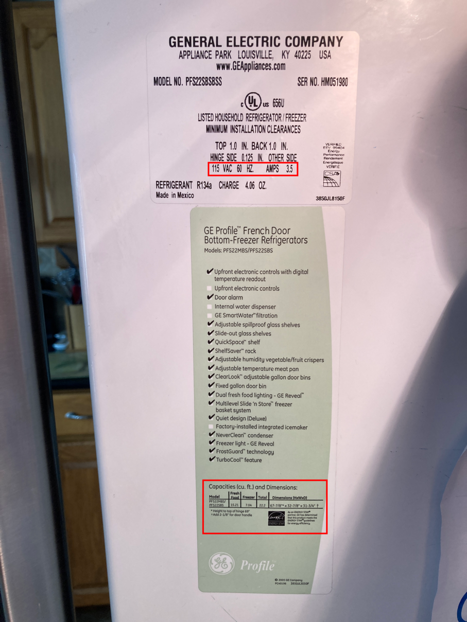

I just stuck my nose inside our refrigerator and this is what I see for its draw :
115 volts X 3.5 amps = 403 watts for a 22 cubic foot freezer/refrigerator without a cooling water pump. Is there any way of checking the amperage draw on your cooling water pump alone ?

What gauge or meter are you looking at to see the present 1,000 watt loading on the compressor. Are you reading the same output gauge or meter when you saw the 100 watt load ?
I can't see 100 watts running a compressor but 1000 watts does seem a little high.

If the same unit was 220 volts, the amp rating would be 1/2 of what is on your label.

Dec 28, 2015
1,917
Yes the amperage would be half for his 220 V supply but the wattage would always be the same regardless of the supply voltage. Of course we can't put just any voltage into the same compressor but you get the idea. The work input to the compressor (measured in watts) will always be the same, regardless of the supplied voltage.
And that information along with $2.50 will get you a cup of coffee in most restaurants.
Sorry, meant to say amps not watts in my previous.
