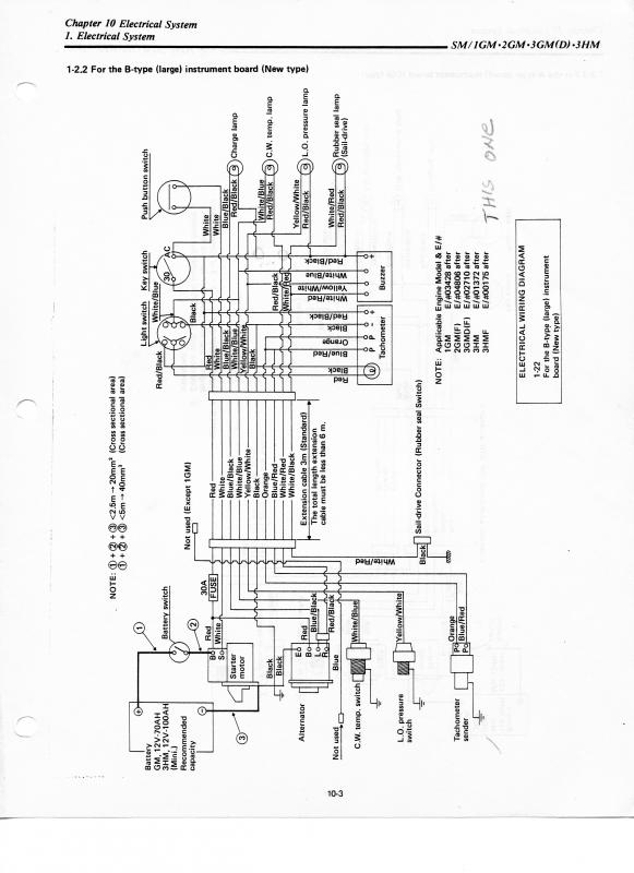

HMT2.. Have ya checked the tacho connections? There is a chronic connection problem in the multiple connections in the harness for the sender wires for the tach. There are two multi-pin connectors and the connections on the sender itself that get loose corroded and the tach stops working. The oil pressure and temperature gauges can be had for $50-$75 .. Folks have installed them in the outside wall of the little storage cubby (with the wood top) so you can see 'em at the helm.. I have attached a wiring diagram that I think (not absolutely sure) goes with your set up..

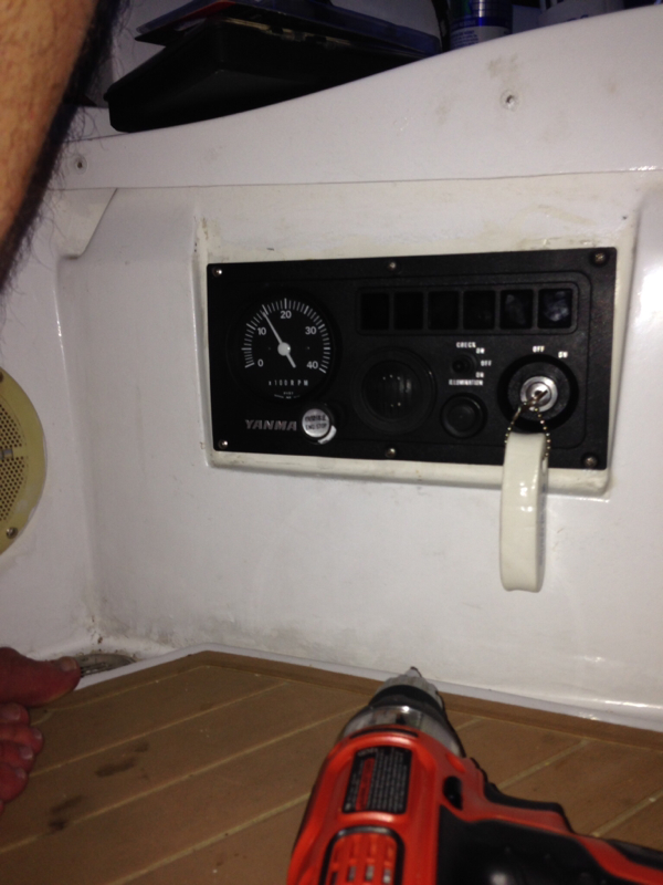

Yes we have checked the connections at the tach sender and tach cleaned them, and reattached same result. I think the connection is good, because when the throttle is up the tach needle moves a little. Planning on attaching a new tach and seeing if that fixes the problem before I go chasing down wires and other connections. BTW found that Yanmar has a blank instrument panel exactly like the one on my 83 h31. Twenty eight bucks, just slip in all the components and idiot lights and our crappy beat up instrument panel will be transformed. We will locate the gauges somewhere near the engine, perhaps where you suggested.. That's the cheap fix. Thanks for the diagram.

Just to follow up. New panel, new tach, new check switch, and new starter button all installed. The problem with my tach was the tach itself.

I got the panel and tach from my local Yanmar dealer. Yacht Equipment Services in Kemah, Texas. The cost for the panel was like $26.00, the tach was pricey at $150.00 but it just plugged right in, new starter button I had already was like thirty dollars. Really a very simple project.
