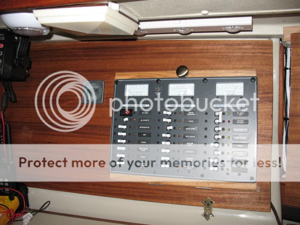

Blue Sea panels all the way. Well made. Prewired. Logical with good diagrams.
I completely rewired Haleakula last year and replaced the 30 year old original C&C Panels
This Blue Sea has 15 DC and 8 AC breakers. Also added a Victorn Battery Monitor.
I placed th panel in so it can fold down on hinges for easy acccess behind it. Also the teak Piece can fold down on hinges by removing the knob. Makes for easy access when needed.
I have placed trim piece between the two teak pieces since I took the picture.

Chef2sail: I like your hinged electrical panel setup. Looks classy & I bet its easy to access your wiring.
Thanks, not as neat as Maine Sail, but did ok for an amatuer. Got the hinge idea from the Bristols a number of other boats we looked at last year. Both the individual Blue Sea Panel and the teak are hinges as eventually I may need to put other instruments into that.

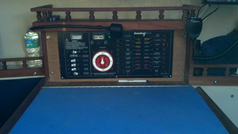

I recently installed this panel. I purchased it from Ken Roy (in parts) down here at the Catalina plant in Largo FL. His phone number is 727-544-6681 not certain on availability? Worth a shot! BOAT PANEL.jpg
