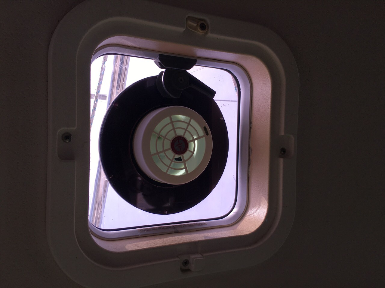

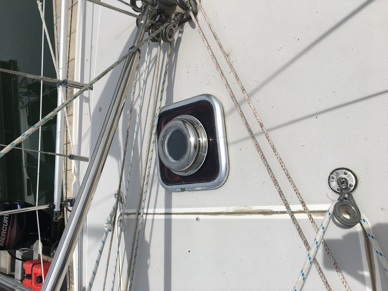

So, I am baffled why the Venturi drain is not standard equipment. I ordered the MarvAir unit from Defender at about $160.00. There are really only three parts that are non standard: The strainer, the 1/4” check valve and the Venturi fitting. Still, $160 is worth it compared to the other drain options. Took about an hour to install it. Filled the drain pan with a couple of quarts of water and turned on the AC. Worked great!
Yes, the drain pan is rusty. I’ll put it on the Winter Project list but for now I am content to have a dry bilge.
Also, cut a 5” hole in the small main salon hatch and installed the solar vent from Amazon. Added a louvered hatch board and now have 24/7 air flow through the boat.
Thanks to all for the advice and thinking these two issues through.
