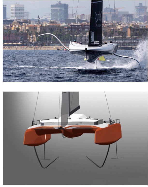

These large foiling monohulls came about because the owner of the defender of the Americas Cup hated Larry Ellison and wanted to get away from his foiling catamarans out of spite.
Foiling catamarans make immanent sense, are relatively easy to design with simpler engineering, fewer critical mechanics, and look more natural (see pic).
There are even several production cruising catamaran designs that now use partial foiling with C-foils to decrease displacement and increase lift. Probably trimarans also, but I'm not as tuned on those.
I agree with many that those foiling monohulls with the bug arms are butt-ugly, an engineering nightmare, and terribly awkward. However, there are designs being made that partially lift the boat, like described above for catamarans. The IMOCA 60 Dali foils are an example. They are still much more complicated than achieving the same thing on a catamaran.
IMO, full foiling will never be a cruising thing. Just too dangerous hitting a wave wrong and crashing back down at foiling speed. Not to mention the maintenance of the foiling systems - particularly on monohulls.
However, using foils to reduce displacement short of full foiling are already here in cruising catamarans, and I expect this to be around the corner in performance-oriented cruising monohulls.

When I see wings on an airplane that resemble the foils in Mark’s pics I’m getting off. I wonder what Arvel Gentry would think?

Foils on multihulls today are really just reshaped daggerboards, and raise/lower the same as they have for eons. The difference is the materials technology that make these foils possible without breaking, along with boat designs that produce faster boats that make the foils more efficient.
That Gunboat G4 in the pic above is a bit of an extreme example, but even those foils are pretty a much normal daggerboard-type and tuck up under the hull when not deployed. The C-foils on cruising catamarans that partially lift the boat are just regular daggerboards with advanced materials and shapes.
Likewise, when I see keels on sailboats that look like airplane wings, I'm getting off.
Water and air are completely different mediums when it comes to foil sizes and shapes. Consider that just one of those 13' AC75 foils fully lifts the 17,000lb boat. To put that in perspective, a Learjet 60 weighs 2,000lbs less and needs a 43' foil to lift it. And the Learjet has speed that allows a wing that short.
Also consider that solid sails on sailboats DO look like airplane wings. Complete with flaps, spoilers, and ailerons.
I thought Arvel Gentry's expertise was in sails, and not foils?
Mark

I’m just amazed that those relatively small foils can lift a 17,000 boat! Yeah I get air and water are different but I don’t know anything about fluid dynamics. I can sorta understand that the more dense fluid, water, could create more lift than air. I appreciate the comparison to the Learjet as it furthers my amazement. I don’t even know how you factor in the speed of a jet vs. a sailboat -even a foiling one. But the foilers are out there so empirically it must work.
