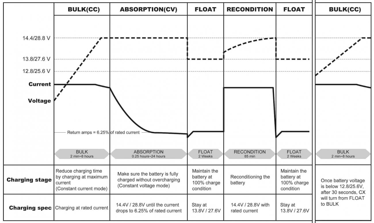

In Trojan's world, bulk is absorption, many chargers call the first phase or charging (100% current... given her all she's got captain) bulk charging the charger stays in bulk until the battery voltage reaches xx.xx V at which point the charger switches to absorption, voltage regulated charge (bulk voltage in Trojans world), Hope that makes sense.
