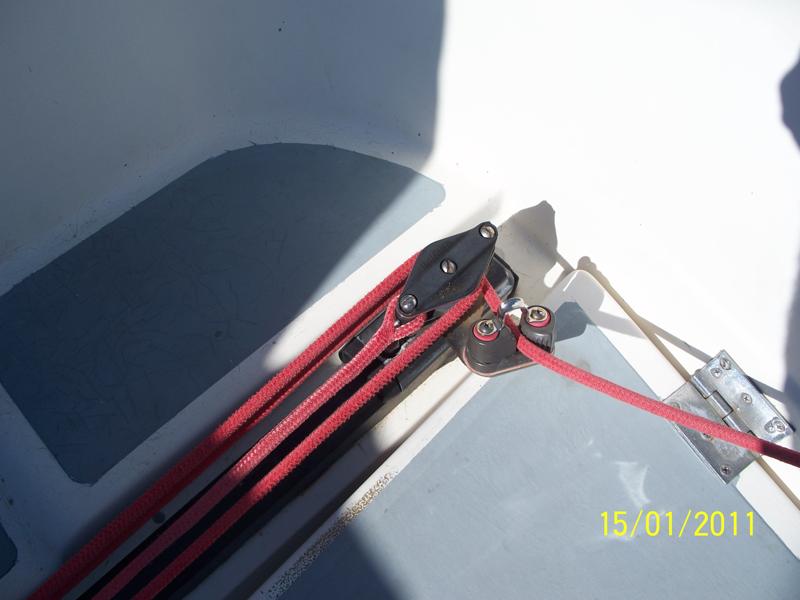

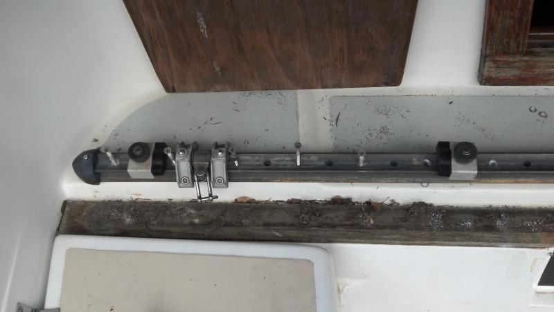

Spring of 2013 I want my traveler to look like Blaise's, see pictures.
Tell me once more how you were able to get the old traveler off of the bridgedeck and bolt on a new one.

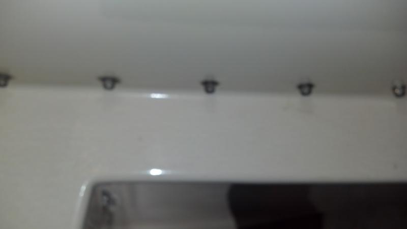

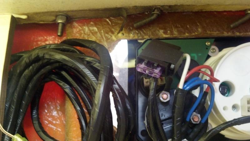

Took some pictures on Thursday. Found in the instrument area that two of the three bolts were bent over definitely requiring them to be cut off. In the q-berth are six bolts. There is one between those six and the three in the center that I cannot see nor feel from the bottom. There are seven to starboard of the three only four of which I can touch. I tried to saw through one with my Bosch oscillating tool to no avail. Not sure whether I can even buy a blade that will cut stainless bolts.
1,065
Wow, that's ugly Ed! On the photo with the engine panel, it looks like they took a hammer to the bolts to get clearance for the panel. Can you get at the bolts with a Sawzall (recip saw)? You can definitely get blade that will cut SS in that range. Or maybe you can get a nut splitter (available at NAPA Autoparts or similar) on there and split the nut off? Good luck and let us know how you make out...

Wow, Ed - Looks way worse than mine did under the panel. And all they needed to do was use shorter bolts! Good suggestion, Blaise, but that sure is a lot of stainless drilling. Best remove what can be removed by traditional means. Those bent ones - I suggest cutting them. I have done same using a Fein multitool with Dremmel cutting blade. It is a bit slow and you will go through a few blades. But once you get half way through, you can wiggle the end back and forth until it snaps off. Remember, whether drilling or cutting stainless, you must go really slowly or you will harden the material.

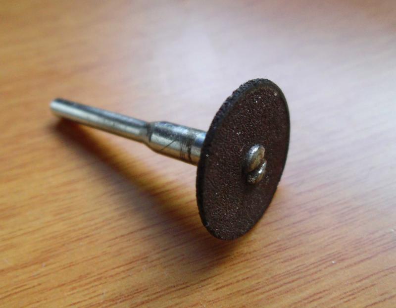

For the from-the-bottom alternative, I have cut through many stainless steel bolts with the Dremel tool cut-off wheel attachment pictured below. The wheels come in two thicknesses. The thinner ones work the best. Also real Dremel brand wheels (or Craftsman brand) are definitely superior to the Harbor Freight no-name variety. If you haven't used these before, note that the wheels are very brittle. Unless you've got a Midas touch, and even if you do, the wheels will most often break before they wear down. When they break, pieces go flying. So eye protection is an absolute must. And if the confines of the working space force the face to be close to the action, also a full face cold weather mask will protect from some stinging. It's important also to keep face and eyes off the plane of the rotational axis.
Even if you don't use the Dremel for this project, I decided to post this info because my Dremel and the various attachments are incredibly useful on my boat. Often the solution that nothing else can substitute for. If you don't have a Dremel, I've seen adds for Dremel knock-offs at Harbor Freight for under $10 -- with a selection of accessories. These will definitely be inferior to the real Dremel or Craftsmen brands, but doesn't cost much to experiment to see if also useful for you. I've got AC powered Dremels/Craftsman. I don't know about the battery powered ones.

Hey guys, that traveler is off and in the garage! I don't even want to think about bolting a new one in it's place. I was lucky that I had a good 3/8" bit with me and drilled the heads off all except the six that are accessible in the quarterberth. After 33 years there were no leaks and the teak base is solid. I'll replace it with plastic teak.

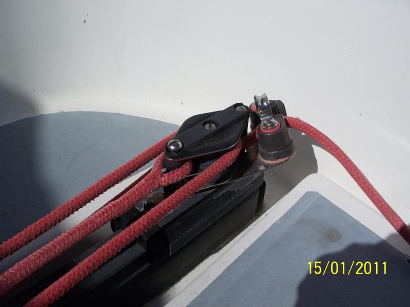

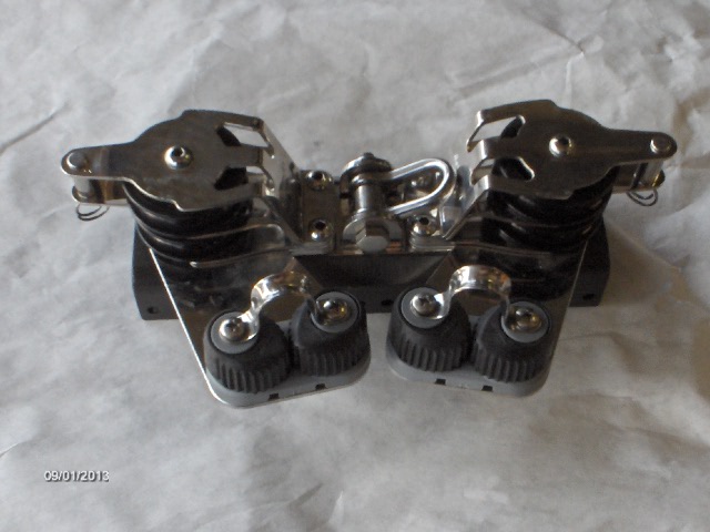

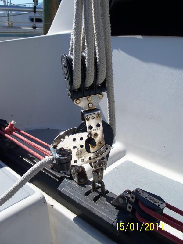

Now Garhauer is working me with to design a replacement. One option is to angle the cam cleats at the end of the track in hopes that the locker lids will clear. You can see that in the second picture(very short track). They tell me that the cleats cannot be angled more. I included Blaise' traveler in picture three for comparison. Then in the fourth picture you can see the option of having the cam cleats on the car itself. But do I want the control lines to come out into the cockpit? Any thoughts?
Forgot to mention that Blaise' cleats swivel to clear the locker(pic #5).

Good luck with Gaurhauer. They make great stuff. I used the Harken high track because it spans long areas without support. Leaving Florida in a week and will have the main with me.

I was the one who cut the bolts off with a Multi - Sonic tool. Flat blades, Lots of the blades About 1 per bolt Only had to do three, bent like yours. I too replaced with the Harkin Hightrack. Drilled 4 holes at each end. First I got rid of the teak. Reglassed and gelcoated the top surface after plugging all previous holes with epoxy. With the Harkin you get to place the holes where you want and no holes are open on the top All hidden inside the rail. Very clean look. I spliced the travler line so there is no lose end the line goes along the edge Again very clean look. Cleats are at the ends. After a full summer sailing with it I just love it. I'll post a pic or two.
