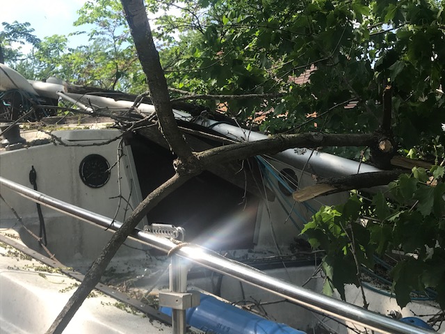

A big Maple limb fell on my 26D. Bent the mast and railing and crushed the sliding hatch. Does anyone have a suggestion on where to find used parts? (in Chicago). BWY is way too expensive for me.

Thank you for all of the replies. The damage is covered under homeowners, but only up to $2000. The BWY mast would consume most of that by the time it shipped to Chicago. There is a definite kink in the mast. I am adventuresome, but my usual passengers are not, so it will require replacement. The original hatch top was lost years ago and is probably along I39 is Wisconsin somewhere. This one was home built from ash and oak. I guess I can build another one, but would prefer to find a used one. There is a crack/crater in the cabin roof, just forward of the starboard winch I did not see until today. The purple plexi companionway hatch is shattered, but no great loss there. If anyone knows of someone parting out a mac within a few hundred miles of Chicago, please let me know. Cheers.

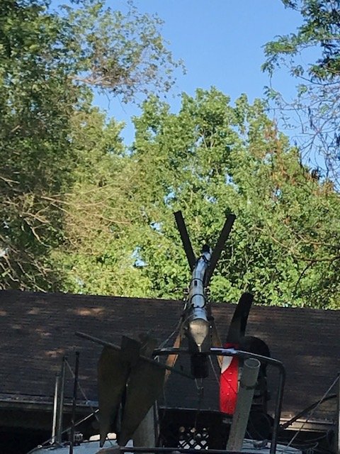

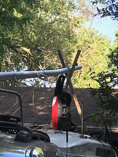

The starboard railing was bent and my yet-to-be-installed stern rail that was in the cockpit. There are a few used masts on craigslist that I could adapt. So far, they are all larger cross section, so no more single handed mast stepping. I finally got some pictures off of my phone.

Ouch! Only consolation is that it was not a result of your own stupidity, as in my case...
Yeah, that kink has got to go. It sounds like you have the skills to straighten those gradual beds if you can find the adequate immovable objects to brace the mast parts against. The sweep of the bend presents a challenge, as will keeping the section from rotating while applying the necessary force.
