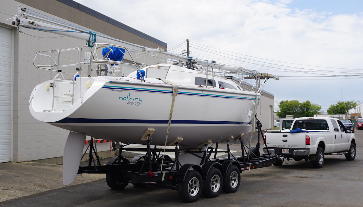

Here's a shot just out of the warehouse after the bottom job in 2016. The gel is still as shiny as this, although in this shot you can't read the license plate of the truck, but get the right angle and you can. This is 1993 gelcoat.
