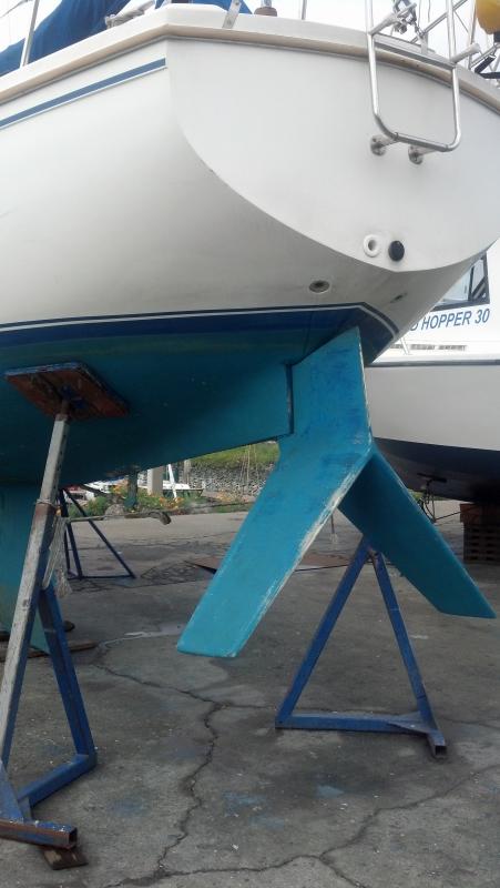

Wow, will you look at that!? How interesting.
My first thought was how easy this rudder would easily catch trap and buoy lines after springing up from the keel, or would be perfect for steadying the vessel during a grounding (strength of this would be doubtful).
I have never sen anything like this in my 50+ years of sailing :confused:. I can see some benefit in stability and agility in the turns, but it looks rather fragile and I have to ask just how strong this rudder is and how susceptible it would be to damage.
Bob
3,027
Catalina 320 Dana Point
I've seen reference to an "Implere Swift Bifurcated Rudder" and a mention in the Mainsheet Technical Tips of May 1991 regarding installation on a Cat 30. There's also a bifurcated sailboat rudder patented in 1989 by Gary L. Hulls of New Holland, PA. The theory seemed to be that when heeled one blade would be straight down and the other horizontal.
Never seen one, they haven't caught on.
PaulK
Dec 1, 2009
1,537
