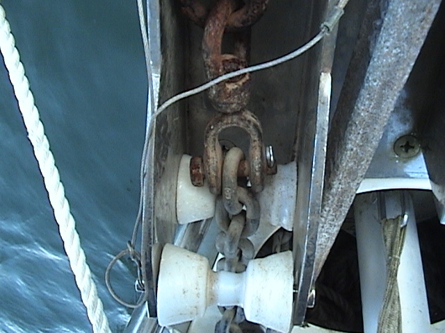

Our 1991 P42 came with an anchor swivel that has held up well over the years. Since taking possession in 2002 we have anchored hundreds of times all over PNW waters and in some very strong sea conditions. Alas it is time to retire this device due to its time-tolled deteriorating state. Such began the hunt for a replacement that has taken several days of searching. It seems most marine chandleries have resorted to stocking off shore products that bring some degree of distrust to such an important piece of equipment.
My requirements remain simple; it must be made in the USA and it must be hot dipped galvanized. One store rep told me good luck finding one anything less than $90-100. Everything around here were made in China and galvanized. No thanks. A Seattle company rep told me that to bring mine in and he was sure he could find something that would work.
Defender carries a swivel that is hot galvanized, but they referred me to their supplier, ALP who was unable to clarify my questions. They in turn referred me to the manufacturer, Chicago Hardware. at 847/455-6609. Mike was very helpful and said that yes, their swivel is hot dipped galvanized, made in the USA, 1260 pounds working load and dropped forged steel. Total price including tax and shipping, wait for it, $32.
Crew will rest well while at anchor in knowing that that weak link has been replaced. The picture below shows the swivel in fair condition, but upon close inspection notice the slightly bent pin and the worn welded nut that secures the swivel joint. Just say'n.

You are correct, Michael. Hard to tell from the picture, but it is the chain to anchor connection. Helps to eliminate rode twist while at anchor.

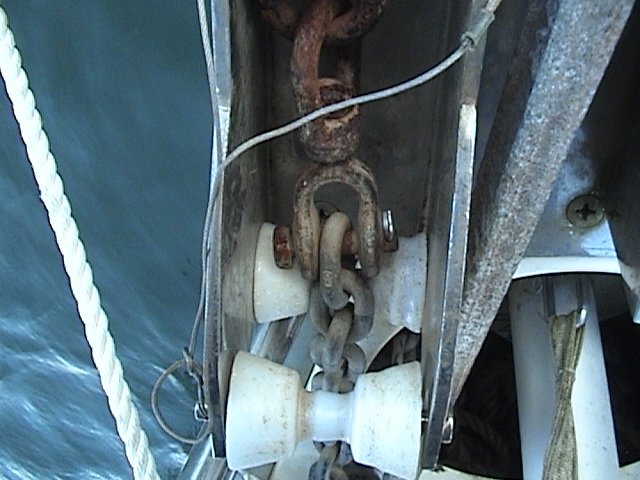

I do have an off topic question, why do you run the chain under the second roller? I would assume that puts a lot of extra stress on the windlass and tears up rollers pretty quickly.
The photo angle is deceiving. The two aft rollers are directly in parallel, one above the other, which is the way it came from the factory. I'm assuming the upper one was placed to prevent the chain from jumping out of the bow roller channel, for whatever reason. The smaller rollers have held up well, with the lower one getting the most wear. I've replaced it twice in almost 30 years of regular use. The upper roller does get some use, coming in handy when paying rode by hand, keeping the rode in the channel. A larger roller on the front is original and has many years of service left. The arrangement places no undue stress on the windlass that I can tell. The design works quite well and am pleased with the system's performance over the years.

I'm sorry to answer without numbers but I don't know the size of other components of the rode system i.e. the chain, clevis pin of the shackle, the anchor rating or windage of the boat. For example ACCO BBB 3/8 chain has a working load limit of 2,650 lbs. So I would want a swivel approaching that. I'm guessing they are either very expensive or not readily available, as OP said.
