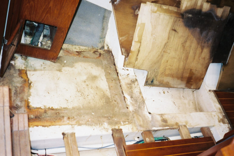

The aft tank is made up from a void in the fiberglass grid liner directly under the nav station. The lid is prone to leak but is repairable.

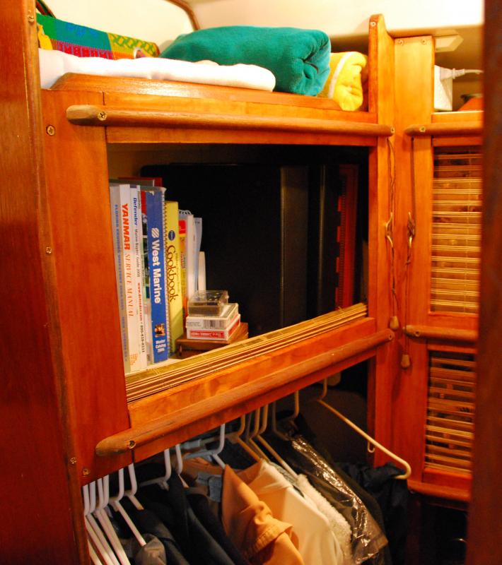

The forward tank is made from another fiberglass void under the forward end of the v-berth. In my opinion the forward head is an abomination and should be removed and used as you suggest (we did.)
In 14 years I have not seen any reliable indication of capacities but I'd estimate each to be in the 15-20 gallon range.
