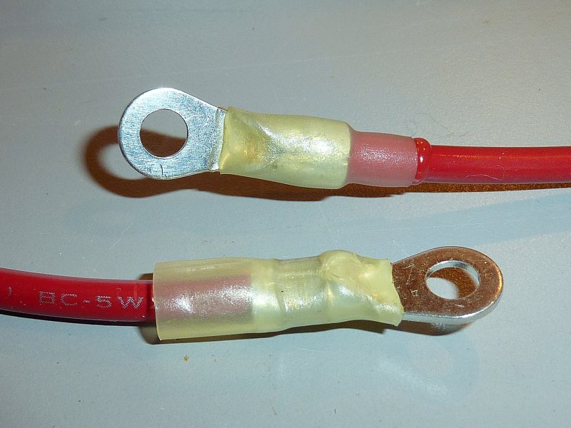

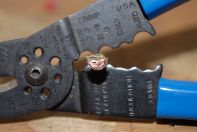

If you use poor crimp tools than moisture could find it's way into the terminal as seen here after being cut open. Notice the individual wire strands still visible.

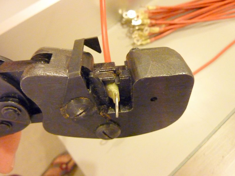

In a properly formed crimp there will be no room for moisture creep:
I made these crimps during the re-wire of my own boat ago and heat shrunk them. To make all 20 took all of about 6-7 minutes. I pay about 0.38 ea for these FTZ 10-12ga ring terminals, so they don't have to be expensive either.
Crimped & Shrunk - Top
Crimped - Bottom
You can see the pile of crimped wires in the back ground.

As I look at mainsail's crimp cut-aways I am forced to wonder, where does the solder go? Not into the crimp. Only on the outside.
I remember the first time I saw those posted. I'd never thought to look that closely; at that time I simple knew I didn't trust anything where the wire could pull out.
Feb 6, 1998
11,772
This is correct with a PROPER crimp tool the solder will only coat the outside of the terminal and there will be no 'wicking" because it physically can't go there.. This is why actual solder/crimp terminals, with the right crimp tool, fold over the barrel and split it so you can flow solder onto the wire in front of and on top of the crimp. Crimp only terminals, the ones I always see soldered, are not intended to do this.
