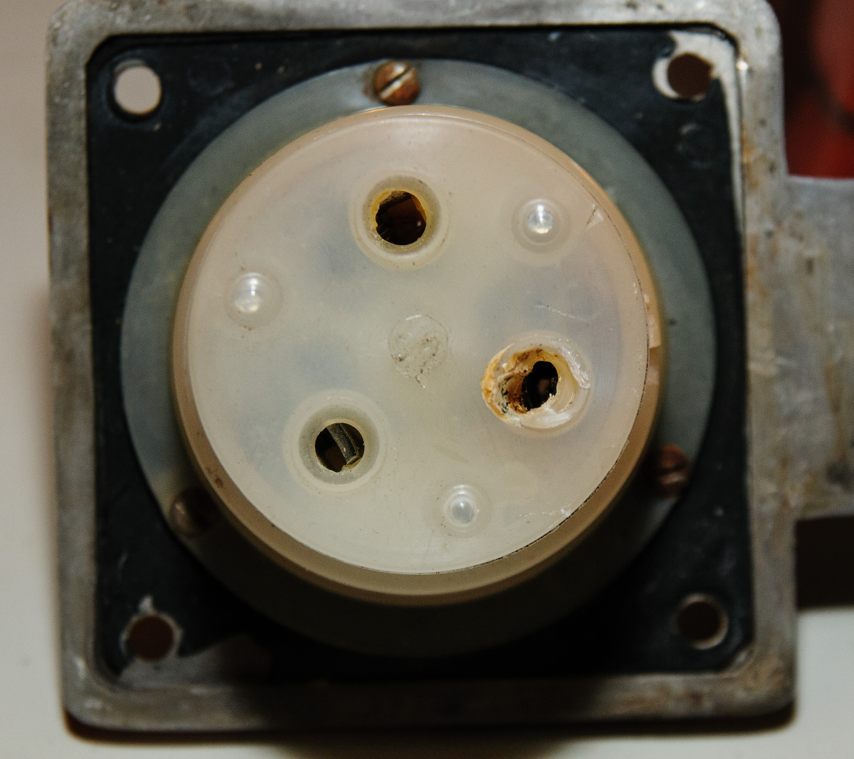

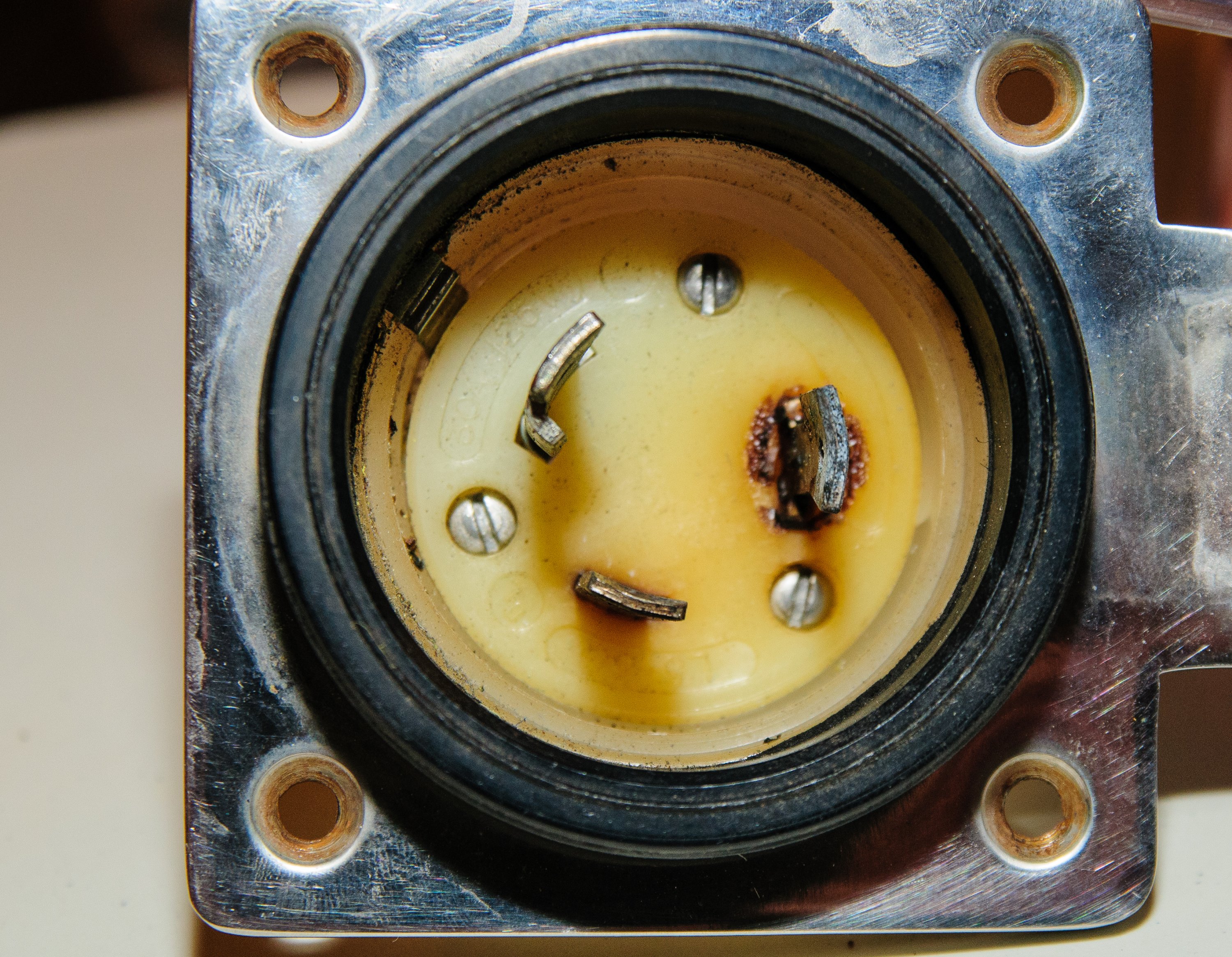

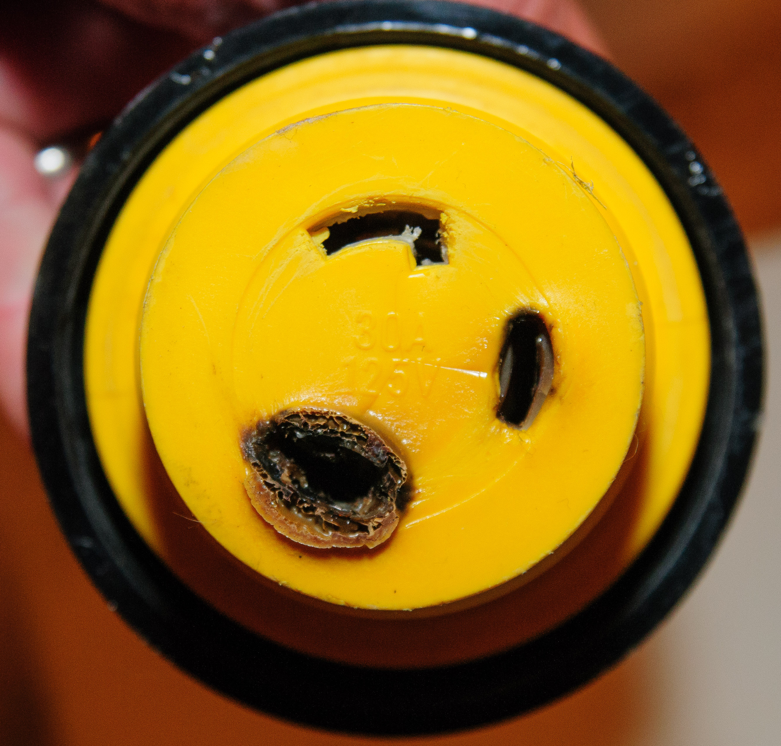

For reasons I don't need to go into here, we were never able to sail Trinity this season, sadly, she didn't once leave her slip. Upon disconnecting the shore power last month, in preparation for haul out, this is what we found. A VERY overheated plug and inlet. After reading Maine Sail's posts on his Compass Marine website a Smart Plug has been on the to do list. Foolishly it was towards the bottom of the list (honestly it's one of those things you just don't think about often). We were very lucky and should have known better! Check those shore power cable folks and always put safety first!

No electrician, but I do have years of electrical experience and practice certain steps to keep issues at bay:
1. Turn the main boat breaker off before connecting/disconnecting shore power.
2. Disconnect the cord at the dock pedestal first when removing cord.
3. Connect cord on boat first when installing for service.
4. When connecting cord on boat/dock pedestal, twist plug firmly clockwise to lock the blades before securing locking ring.
5. A lanyard on the dock end of the cord is used to wrap around the pedestal to secure the plug to the socket. Most dock pedestals have no means of accepting a locking ring and the lanyard serves that purpose.
Boats move around when the wind pipes up and can, at times, put a strain on the cord set connections. I installed a strain reliever on the boat end that is clipped to a stanchion to take up any stress on the plug. One time, before the strain reliever, arrived at the boat to find the boat end locking ring broken and the plug hanging partly out of the socket.
A cord set was ruined early on in my boating days because I was not following the above steps. It looked just like the one pictured by the thread poster. Maybe some day a conversion to Smart Plug will happen. But as long as what we have works without issues...

  1. Clean the tines several times per year.
  2. Keep a thin coating of grease. Coorosion is the whole problem. Practical Sailor has a review coming out next month, I believe--not all are equal.
  3. Keep the area dry. A cover is a good idea if the dodger doesn't cover it. They are supposed to be water resistant, but....
  4. Test the plug for warming under load periodically. Put a couple space heaters on it and see if it warms.

  1. Keep a thin coating of grease. Coorosion is the whole problem.
I think corrosion may be A problem, but certainly not the whole problem...
Poor connection between the plug and receptacle is also detailed in Mainsail's article. Without complete connection, the current is drawn through a smaller connection causing greater heating and eventual failure... and possibly fire.

OK. Perhaps 85%. I've investigated MANY failed exterior plug connectors in industry over the years, and corrosion is at fault more than 90% of the time. With boats, I'm sure more so. Then once the connector starts to heat the female side will loose tension. Wear can also be a factor, particularly if there is vibration (industry) or motion (boats); secure the plug so that is NEVER feels the motion. But even then lube helps. Just put it on the spring list.
Like any plug, it should feel snug and not rattly.
