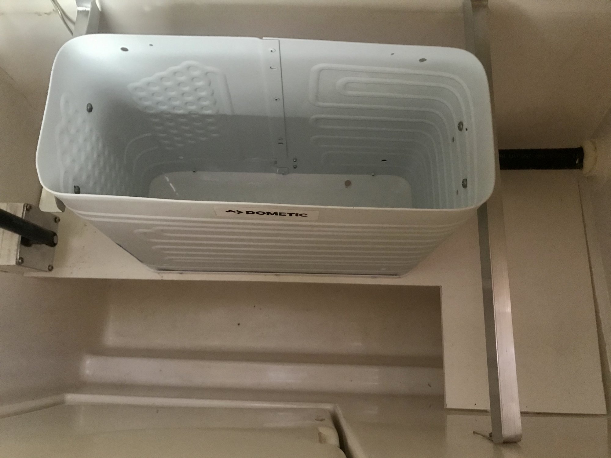

Happy New Year John. I have a 2005 H38. The one thing I think you can improve on your boat is the air circulation at the back of the fridge/freezer. I think the way the carpentry shop was set up at Hunter Marine the air circulation had to be insufficient. There are air circulation holes, but the cabinet next to the fridge does not have holes, so the air can not circulate. If this is the case on your boat, you will improve your fridge cold and consume less Amp hours.
