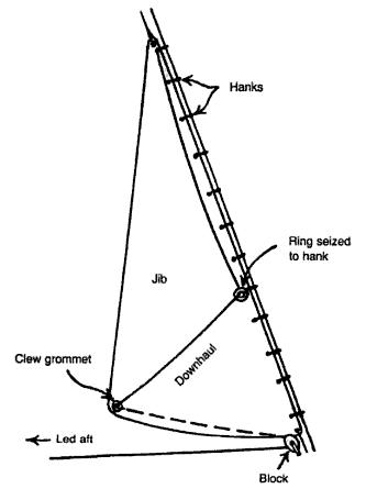

I used a variation of what you described, the Gerr downhaul. When you Google it you'll find a diagram that shows how it not only brings down the jib, but secures it in a bundle at the forest at. VERY useful if you are changing headsails in a breeze.

Glad it worked for you. BUT, BUT, BUT, it simply WON'T work for many, because if you attach it to the jib halyard, when you pull it down the downhaul will cock the top hank and could very easily create a tight spot, making it hard if not impossible to pull it down at all. Plus there is absolutely no need to put the downhaul line through any of the hanks. Clip the downhaul line to the second hank from the top, lead it far down to the tack of the sail on the deck and a simple block and lead it aft, like the picture in the photo I provided shows.

The "Gerr" downhaul system, the second picture of Granger's post, was presented in this forum at least ten years ago.... I rigged my downhaul that way and was quite disappointed in it's practicality. The downhaul is routed through a mid luff ring, back to the clew, then forward to the tack before running all the way back to the cockpit. The premise is that keeping the halyard cleated, releasing the sheet, and hauling on the downhaul allows the crew to "clew up" the sail for a temporary reef.... i.e. the clew is drawn up to the mid luff ring.... just like on a square rigged sail. If you keep the sheet cleated, and release the halyard, the downhaul will draw the sail down to the deck.... theoretically bringing the mid luff ring with it.... ANYHOW... it really doesn't work like that.... and there is a lot of friction with rings and clew grommets for the downhaul to thread through....The sail gets bunched up and the downhaul line gets tangled in it. I experimented with it quite extensively and decided that my boat was simply too big (27 ft) even with the blade (110) hanked on..... so I removed the gear and went with the simple down haul for the purpose mentioned above.... It has become an important part of my sail handling system.... especially when single handing.
The system might work on a smaller boat... under 20 ft perhaps... or something like a West Wight Potter... but not on a mid size or larger vessel.

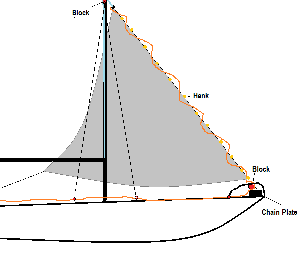

This guy has it going on! Check out the diagram. I am doing this this year!!
http://www.widgetsailor.com/myboat/downhaul/
FWIW, I tried that setup when I rigged mine a year or so ago...TOO MUCH FRICTION! The concept is brilliant, it just does not work. I run a 1/4" line clipped to the second hank passed through a steel ring mid luff to control the lazy downhaul. Very effecitve in dousinhg the jib. If your jib is over 100% then you will need some system to keep it on deck and out of the water when doused, if you have lifelines this should do it. I don't but I use a 100% and with one of the sheets tight the jib stays on deck.

For those saying too much friction, I'm wondering what kinda line you're using and how big it is. The spectra/amsteel/dyneema/whatever line that I'm using is so slick it's almost difficult to grab onto, and so thin that it easily fits through the hanks with plenty of room to spare. It's not like this line really gets any load on it, so there's no reason for something heavy duty, regardless I think the line I'm using is still rated for 500lbs or something silly.
