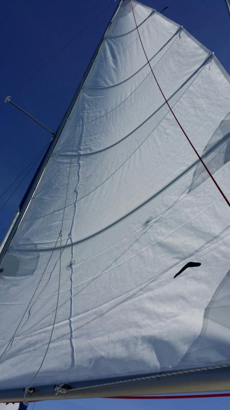

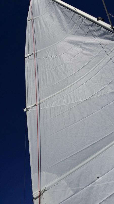

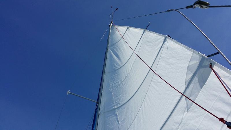

I've been keeping quiet about this topic, mostly because I had no idea that the whole thing could end up blowing up in my face.
The story is not over just yet, but at the moment I am very unhappy with my sails from the company that cannot be mentioned. As great as they appeared to be from my first look-over, as it turns out they were not made from the Challenge warp Drive 6.11 cloth that I paid for.
I was a little bit irritated at first at how this thread changed from an initial positive product review into a debate; however I have to give Dr Judy credit and thanks. She pointed out to me that my sails did not look like the correct cloth. I called the Challenge Rep in Costa Mesa and they were happy to send me a swatch book of Challenge Warp Drive Sail cloth. Comparing the sample to my sails it was obvious to the naked eye, my sails were NOT Warp Drive 6.11
I'm left with a bad taste in my mouth, and it has been a nightmare working on the solution but it is in process. I hope that no one here has bought sails from the same company based on my original review. I have little confidence that they can be trusted.
