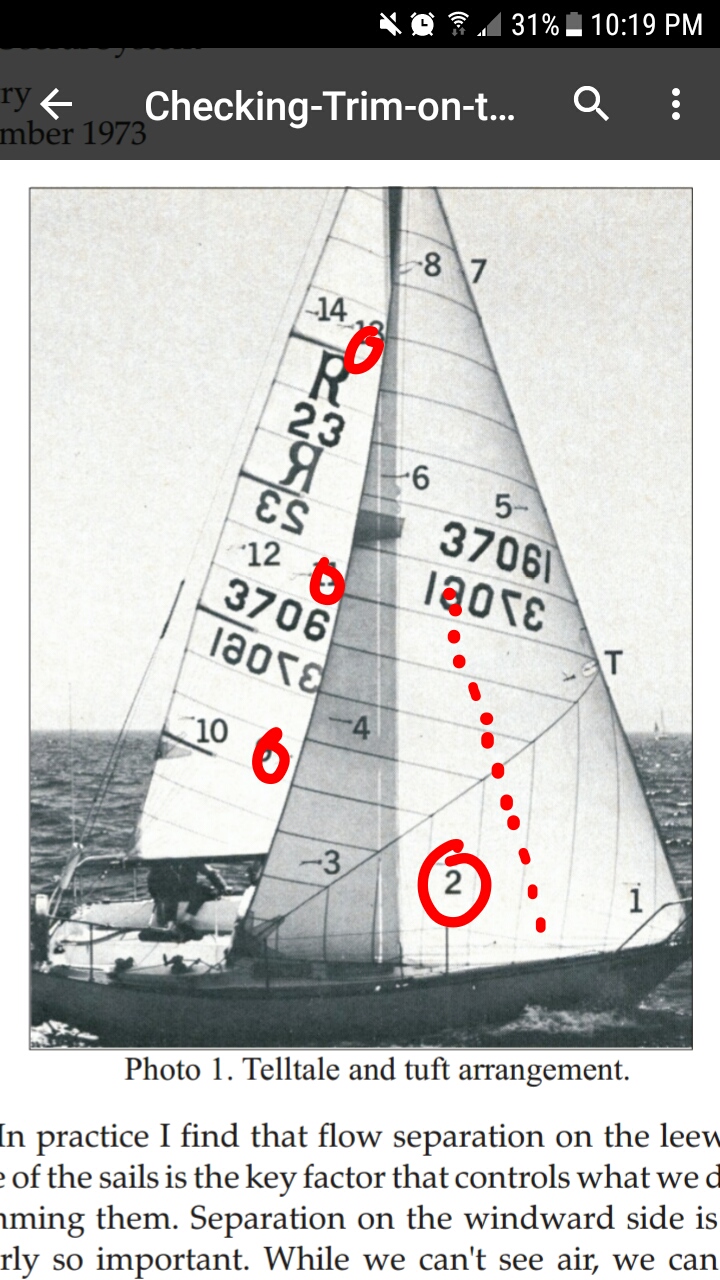

Check this out from Gentry.
http://www.gentrysailing.com/theory.html
the circled telltales will tell you if you have the draft right. if those are flopping around you need more pull on the outhaul (flatter sail). if you have full outhaul and still floppy telltales, its time to reef. No need to guess on what outhaul should be.
