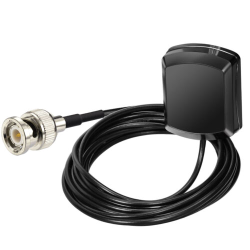

In case it was the GPS, I found this on ebay...
Hi John. Thanks for the tip. Saw that on the e-bay site yesterday, too, as I was looking for a used 178C Sounder. Our antenna is a round white rail mounted puck. Unsure what caused the kerfuffle. Morning sickness, headache, tired, menses, etc. :)
