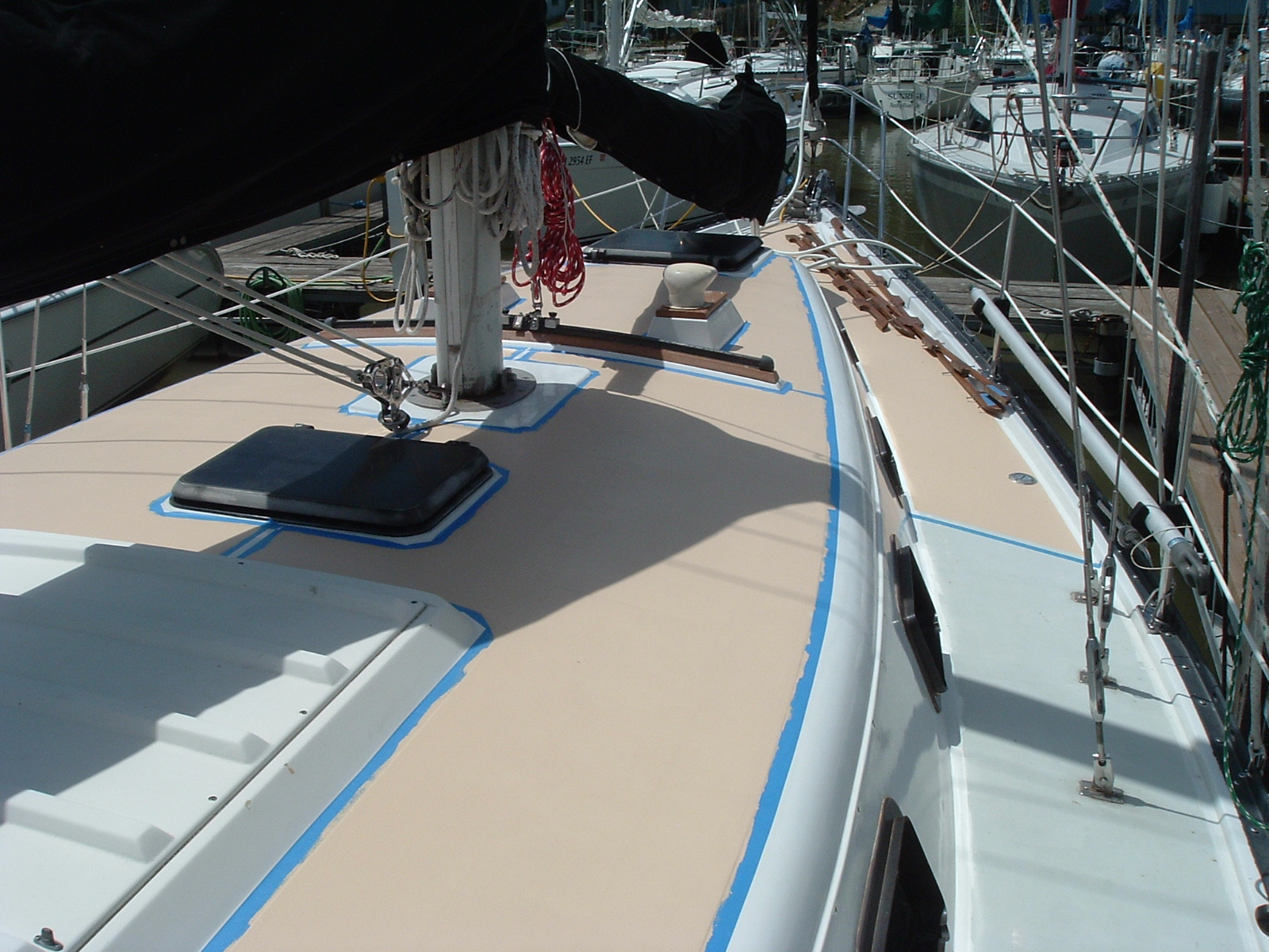

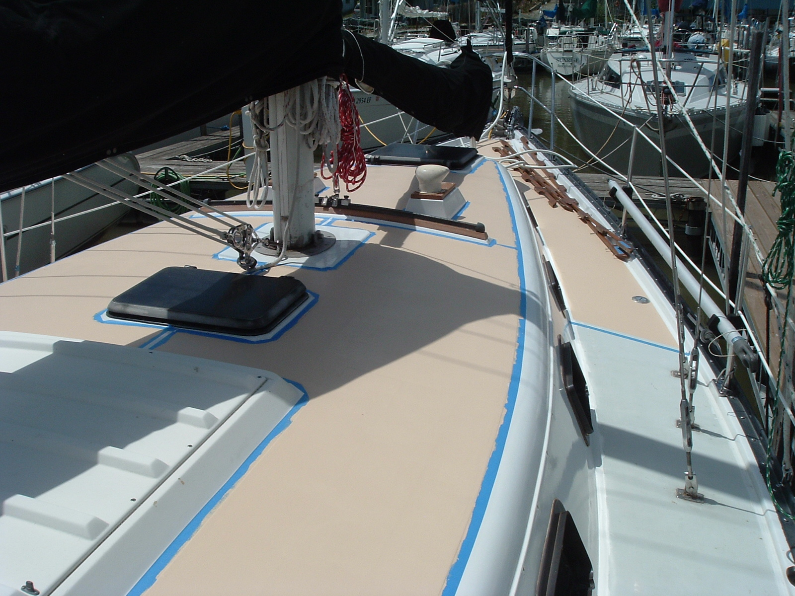

Two-part is better but much harder to apply IMHO. I did my decks with Interlux Toplac which I found flowed better than Brightside. Ten years later it still looks good. The picture is of a new coat of Interlux Interdeck non-skid but you can see how the cabin sides look.
Ed, what kind of prep did you have to do to the cabin before the Toplac? Did you use a primer?
Jun 2, 2004
5,802
Actually Jim the primer was Brightside. I had cleaned and lightly sanded, probably a 220 grit. Then I painted with Brightside and had trouble tipping it out. So I sanded again and applied the Toplac. So not sure, results have been good but maybe better with primer.
