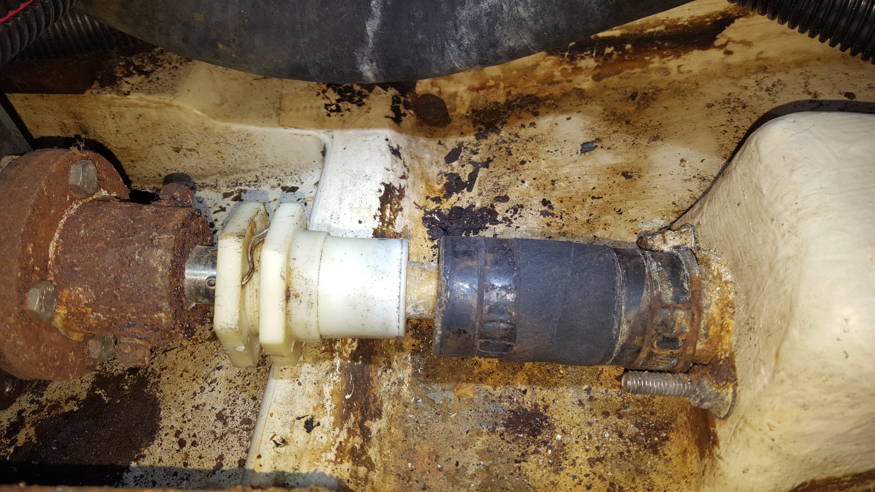

New member here looking for a little help. I bought a 1990 Hunter 28 a few months ago, and on the list of repairs for this neglected lady was a leaking stuffing box. Well, yesterday was the day, and I clamored back into the aft cabin and had at her. I didn't have the right sized wrenches for the nuts, and they wouldn't come undone by hand, so I undid the hose clamps and slid everything forward. I started fishing around for the packing .. and fished ... and fished ... and fished. Finally, I realized ... there wasn't any! No wonder it was leaking.

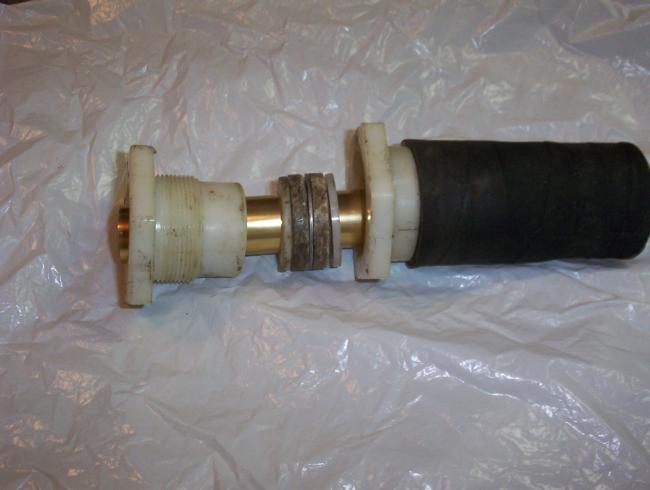

Turning to the internet, I found a picture of one for a 280, and noticed that the owner mentioned something about nylon washers that are fore and aft of the packing. Well ... I don't have those.
So, are there any Hunter owners out there that have a stuffing box like those in the attached picture that could lend a little advice on whether or not the 28 had those washers?? The thing is, if they aren't there, that means I probably have to pull the shaft. And if I do, I might was well replace it with a drip-less stuffing box. I was hoping to avoid all of that labor and expense though.

The packing is between those two big nylon nuts not in the hose you disconnected

Just be careful with the nylon threads when removing the old flex as well as when tightening the compression nut as not to overtighten. The flex fits indeed between the two nuts. From looking at your photo the forward nylon piece is the compression nut and the one that connects to the hose is the recipient of the flex. Make sure you use the correct flex and pack the required number of rings. Do not know the specs for the shaft or nylon box. You will have to put the boat back in the water to test it and give it a final adjustment.

Yeah .. I figured out where the packing went after I posted and had a 'duh' moment.
When I took the gland apart, there were three washers and three pieces of packing. The order, from fore to aft, was packing, washer, packing, packing, washer, washer. I don't think that's right. I think it should be washer, packing, washer, packing, washer. Can anyone verify?? Also, the packing appeared to be two different types, but seems to be 1/4".

There is a series of posts on this site called '88 Legend 35 stuffing box that describes your stuffing box properly. Like the thread says it is a GW Morse shaft seal, NOT a conventional stuffing box. Google the Glenwood Marine catalog page 35. Here is a picture of one taken apart. I have one installed on my 1991 Hunter 30T and have only had to adjust it once in the past 10 years or so. This type of seal does not drip and runs cool. Just remove the cotter pin and turn the inside nut by hand (no wrench required) one flat at a time to stop the dripping. I have had fantastic luck with this seal. Hope this helps.

Perfect Fred! Thank you very much. That's what made sense to me, but it's great having it verified with a picture.

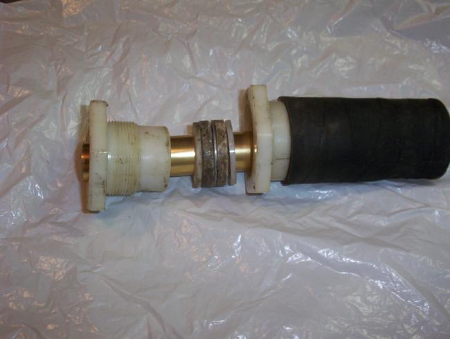

This is a picture I took of the OEM white stuffing box that was on my 1986 Hunter 28.5. IMHO, don't bother trying to replace the packing in this unit; throw the whole thing away and replace it with a bronze gland. You'll be able to service it more easily and your boat (and you) will be a lot safer.
