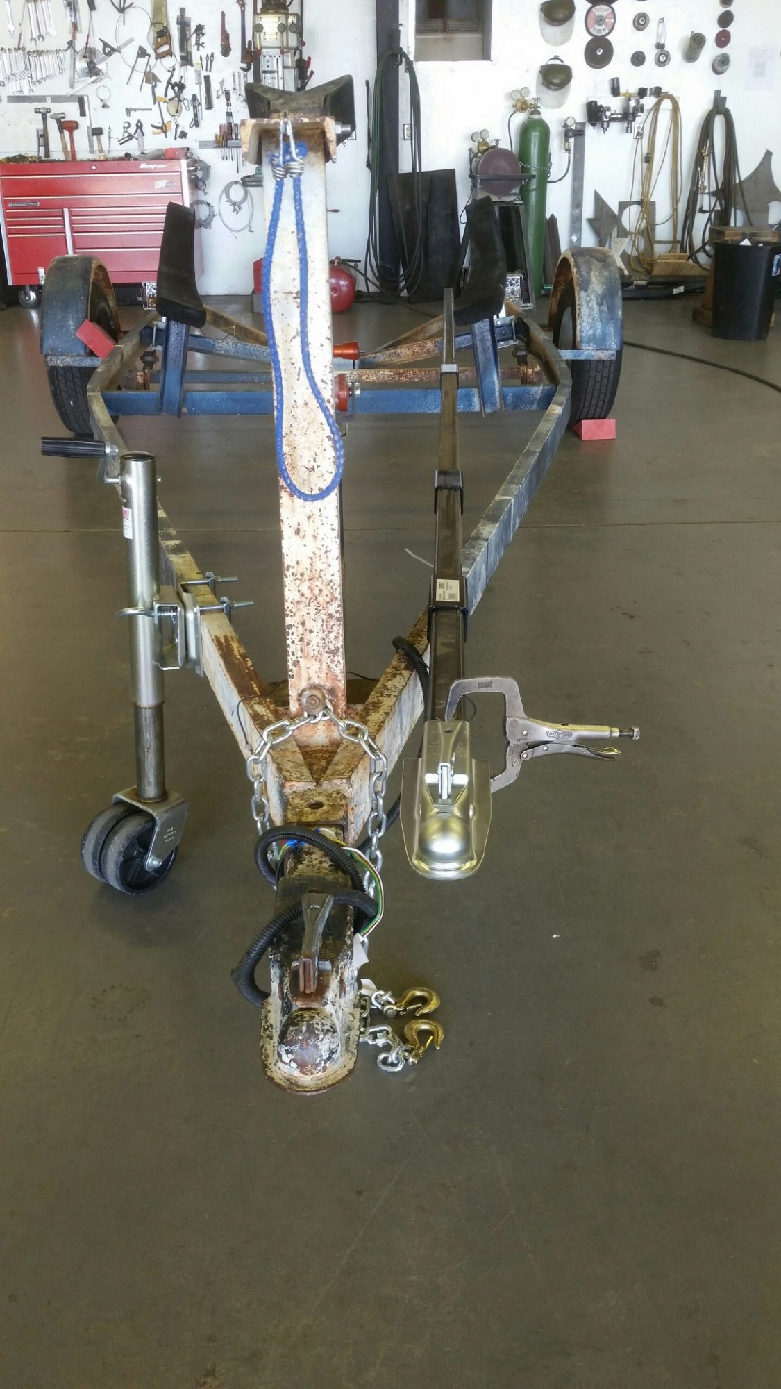

Totally get it-- had the exact same challenge when I got my original from the PO. I had to decide: spend about 900 on existing trailer refurb or go all in on custom new. I opted to fix and my answer to the extension mock up is shown below. For that 900 ish the local trailer shop did this part for me, I upgraded the axle, bunks, supports, keel stop, wheel/hubs, springs.
I had them weld the stock extension shut (we couldn't unstick it anyway) and i swap back and forth in the parking lot to the extension (adjustable from 6-10 feet) and back to the main for the tow home.

Quick observation, if you ran your safety chain around the back of the jack post it would give it a much better chance of staying attached to the trailer rather than relying on the one bolt to take the shock and load of the trailer if it lost the attachment to the tow vehicle
Yep- old picture, long since removed and while they were adding the extension-- we welded proper loops for the safety chain.
