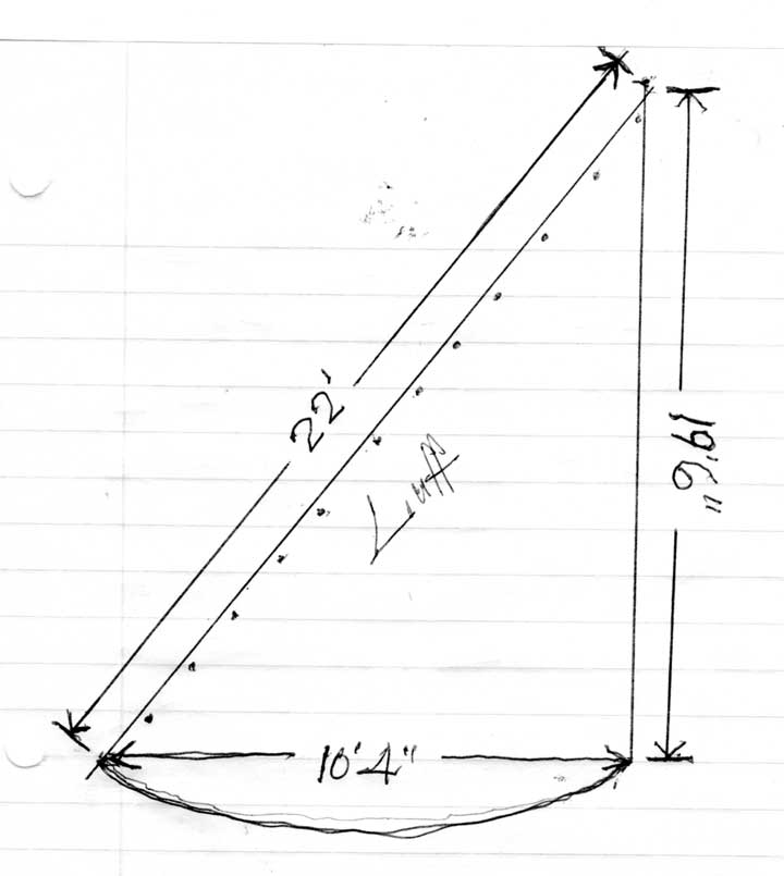

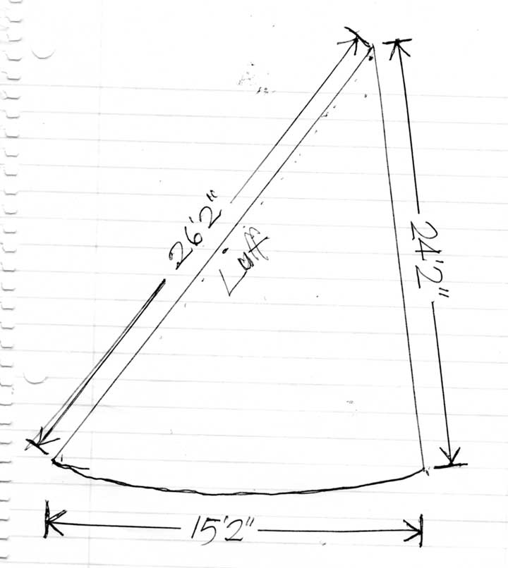

Having a first look at the sails, and could use a little help figuring out what I've got.
My mast measures 23 feet.
In bag #1 is what looks like a jib and a genoa.... but the genoa looks too big?
What I think might be the jib:
What I'm guessing is about a 130% genoa...?

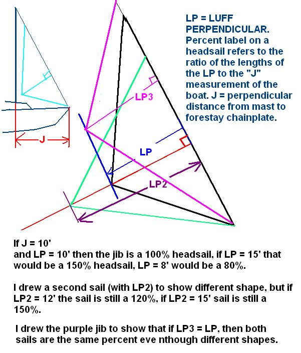

If you have the sails down and can still measure them, take a tape measure and find the shortest distance between the clew and the luff. This will give you a Luff Perpendicular value that you can use to calculate what they are.
This article was hard to follow but gives the details on how to find it:4.2 - Genoas and Other Jibs — UK Sailmakers
Joe
Jun 1, 2004
8,258
Measure a perpendicular line from the luff (the longest side that has the hank on pistons) to the clew (the corner opposite the luff) Geometry lesson aside, you're comparing the area of the headsail with the area of the foretriangle (which is a RIGHT triangle formed by the mast, foredeck and the forestay.) Therefore, the shortcut is to divide the length of the foredeck into the perpendicular line on the luff (LP luff perpendicular, or the height of the triangle). In sail measurement terms the foredeck length (from stem to mast) is designated as the "J" and is conveniently listed in your owner manual, all promotional flyers and on SailboatData.com - CATALINA 22 Sailboat example: If you're J is 8.0 ft and your LP is 8.8 ft .... your sail is a 110% jib if it's the smaller of the two, the larger sail will be the genoa. Btw... headsails rarely have 90 deg angles at any corner. That's why the LP (or triangle height) must be used. It also means that even a 100% jib will have some overlap, where the clew extends aft of the mast. The overlap, besides the LP of course, will also be affected by the cut of the sail. i.e how high the clew is positioned.

Even though your mast is 23’ it sits on the deck slightly above the tack of the jib. The I measurement is the one that gives the total height from headstay tack to the top. The I measurement on a Catalina 22 is 25.85 feet. So with a J of 8’ and I of 25.85’ your headstay length is actually the square root of (25.85^2 + 8^2), which is 27.04’. So your genoa with a luff of 26’ 2” should fit fine.
