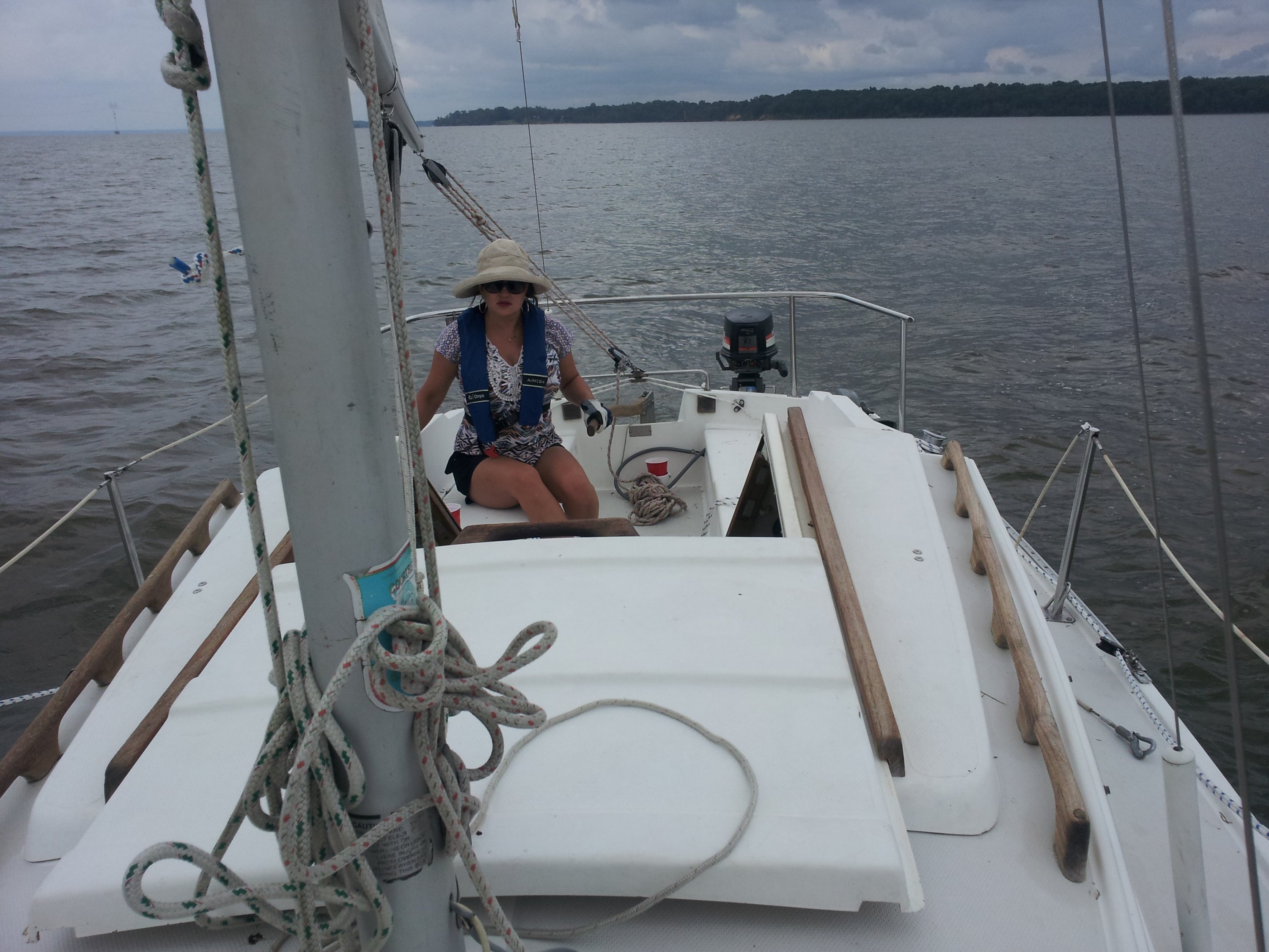

On my 1984, there are water channels below the lids of the lazerettes. On the port lazerette, there is enough room in that channel for the fuel hose. I trimmed a small "U" in the rear outboard corner of the lip that supports the port lazerette hatch. I run the fuel hose through that opening, along the channel, and to the motor. This allows you to keep the lid closed with the hose connected to the outboard. When I'm not using the boat, I disconnect the fuel hose and stow it. The top of the lid keeps rain water out and rain water flowing though the channel doesn't reach the top of the "U". I don't have a good picture of the opening but if you can wait a week or so, I can post one.

In this picture, you can see the fuel line running through the water channel of the port lazerette (near the red cup). The fuel line isn't connected to the motor in this picture but if it was, it would run under the main sheet traveler car.
