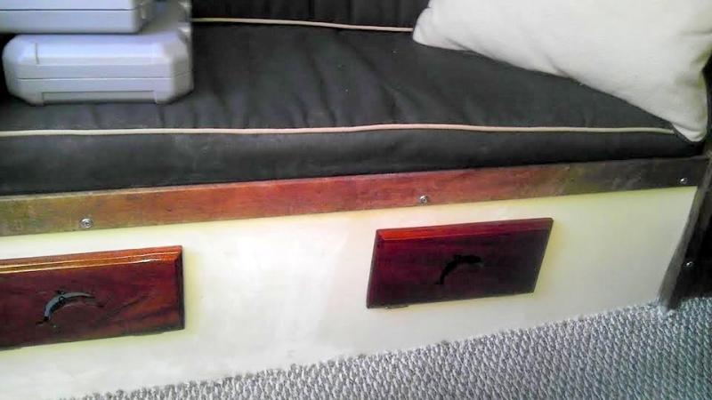

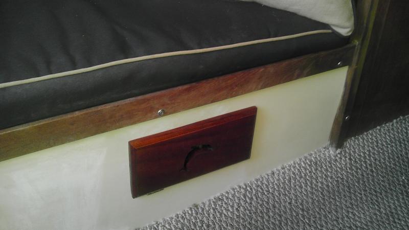

I don't have a lot of patience for polishing and finishing so I was planning on painting the bottom of the boat liner. The boat was submerged for what must have been a year before I bought it. The gelcoat was stained deeply with a green tinge. I tried bleach, 409 and cleanser. Nothing got rid of the stain. I was installing the doors this weekend and decided to paint them before mounting them. I decided to sand them down to get rid of the gloss. I noticed that the stain disappeared after sanding with 120 grit paper on my Multimate tool. I remembered that others had done the same so I stepped down to 240 and finally 600 grit. All was gong well and it just needed a compound rub out and polish.
Polishing in that small of an area and in all of those crevices could not be done with the polisher and as stated I have not tolerance for hand rubbing.
That's when it occurred to me to attach the microfiber rag to the Multimate pad. The pad has hooks that grab the microfiber towel. With a daub of compound I applied with the Multimate. It worked like a charm. I was able to get into all of the corners and crevices. That section was done in less than 10 minutes. You an see the comparison with the the section that was just sanded with the 120.
This will especially be handy when polishing the cockpit and deck. I am actually looking forward to that job now.
