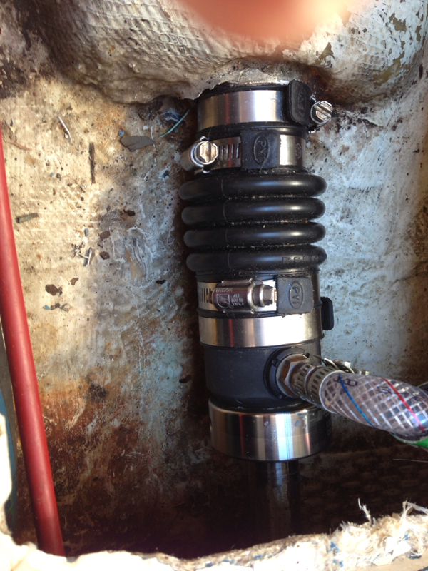

And one more item; being the paranoid type (something about a potential hole below the waterline) we got the shaft clamp. The little set screws are a little small, the clamp is an inch thick, with nice thick bolts. Changing the whole works at once with a "faced" shaft from CD was probably a little more money, but the closest boatyard beyond my garage is 800 miles, so knowing the parts would fit right the first time was worth it. The whole job can be done in a day, except that CD requires an exact shaft length measurement, and that's hard to do without removing it. The factory brass shaft slices really easily with a 4" cutoff wheel and if you remove the old one that way, you don't have to deal with the coupler being "welded" to the shaft. If you cut it off that way, be sure to add the thickness of the cut to the shaft length.

There's another benefit to the PSS seal - less boat smell.
If you're in salt water the bilge can start to smell funky when the boat is closed up for a while. This can be an issue with your significant other, especially when clothes and bedding stored on board start to smell like old boat. A dry bilge makes a big difference with boat smell.
If you're going with a new shaft consider a split coupling. It will make removing the shaft for service much easier. The retaining ring is a safety item. Check with Defender. When I looked up PSS on their site the photo of the PSS seal now shows the retaining ring so it may be included.

Just to add my $0.02, I did the wholesale change last spring, as well. And I am quite happy I did.
A few things to keep in mind:
- Catalina Direct sells a great combo (shaft and coupling). Spend the extra $40 for the matching job.
- triple check the size of your coupling; I had a problem that they sent the wrong size.
- if you are on the hard for winter, start the ordering process early. CD delays cost me at least four weeks of the season.
- PSS does not come with the extra retention ring (at least did not last year). But order it together to save the shipping costs. A good place in Canada for PSS product is Marine Outfitters in Hamilton, but you may find them at better prices close to your home.
- make sure that you have the right compression on the bellows; when mine was installed (by a local contractor), the compression was off (not enough). If the compression is not right the seal would leak.
- Check carefully, where you water level is. When you look from inside (engine bay) it is surprisingly high. You may want to start with a long transparent tube for the breathing tube (it would show the water level). General consensus is that that a plastic tube is not a good choice for under water line applications.
- some report (compare Maine Sail) that almost regardless how high your breathing tube ends it would burp some water on occasion; usually due to some dynamic pressure caused by the reverse thrust. Some interesting contraptions have been installed to prevent this.
- I changed the cutlass bearing at the same time. I strongly recommend doing it.
