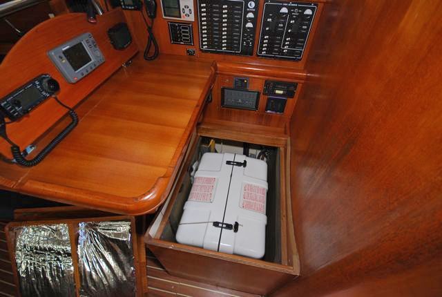

Hi I have a FP 7kw on my new boat and it is installed under the Navigation seat. I notice it is sea water cooled.

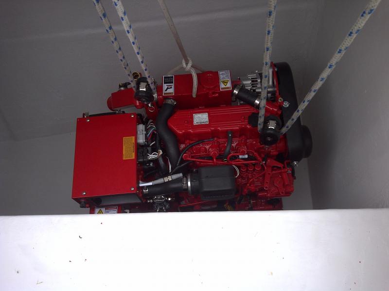

I started this thread with the question of what genset would be the best to install on my H41. After several months of research I purchased a Westerbeke 5.5 KW and have it now placed in the portside cockpit locker. Access ports have been cut in the stern cabin for installation and maintenance.
The gennie is not operational yet, and therefore I cannot report on my success or lack thereof, but I thought readers might be interested in seeing how she fits - see attached.
