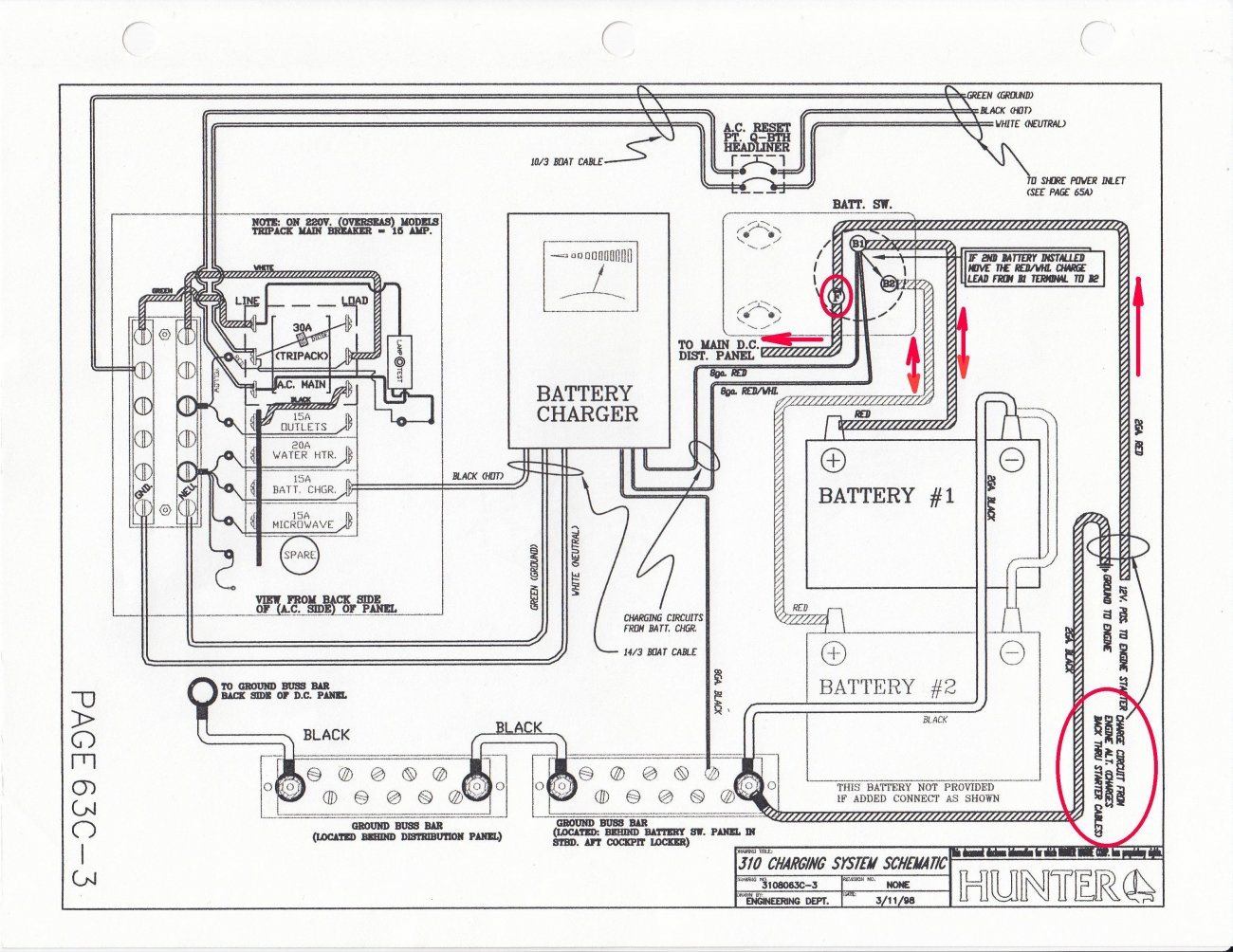

On something as important as your electrical wiring, you should have a copy of your own system and not rely on opinions. A search of the treasure trove of boat manuals on this site may just produce the drawings you are after.
To my knowledge, later model Hunters have the same wiring as shown here on my '99:
When the output from your alternator (circled note on RH side) leads to the common pole of your battery switch (shown as F) the current can be directed to 1 (B1), or 2 (B2), or BOTH (B1+B2). For this reason, with this wiring arrangement, you would never turn the battery switch to OFF or there go the diodes in your alternator.
Normally when running on engine, we turn the switch to BOTH to make sure everything is being charged.

[/QUOTE]When the output from your alternator (circled note on RH side) leads to the common pole of your battery switch (shown as F) the current can be directed to 1 (B1), or 2 (B2), or BOTH (B1+B2). For this reason, with this wiring arrangement, you would never turn the battery switch to OFF or there go the diodes in your alternator.
Normally when running on engine, we turn the switch to BOTH to make sure everything is being charged.[/QUOTE]
Thank you ever so much Ralph that makes perfect sense. :)
