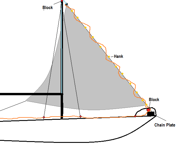

In a down haul system, you put a block (pulley) at on the chainplate where the tack of the jib is attached. You run a small line up the sail and attach it to the last hank near the head plate. The line is weaved in between each hank. Run the other end of the line through fair leads back to the cockpit. When you want to dowse your headsail, you release the halyard and pull on the down haul. the sail collapses in a nice flaked manner and if you leave one of your jib sheets taunt, the sail will lay nice and quite against that gunwale. With the down haul and sheet taught, it will sit on the deck and not flap around. You can then deal with it later once the weather has calmed down. If you also have a solent sail system, you can use this technique to quickly dowse a large sail and just as quickly raise a storm jib without leaving the cockpit. I drew a crude picture of a down haul ... hope this gives you something to think on and good luck with your outfitting. And if you do a search for a solent sail system, you will get some good ideas there too.

I like the Pardey downhaul idea (what rgranger describes) best of all. It's easy to rig and can (should) be led, like a furling line, aft to the cockpit. Add netting to the pulpit and back to the first stanchion and it's far cheaper than a furler. You can pull the sail right down onto the deck because, having hanks, it will flake itself into a nice tight accordion and stay put, and you're still in the cockpit. You can't do that with a headstay foil or furler, ever. Lead your anchor rode to a cleat farther aft and it's not in the way.

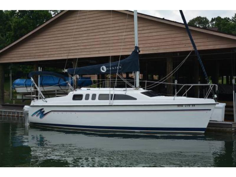

The boat in my avitar is a Balboa. I just sold it this past weekend (the new owner has not picked it up yet) and I am now the proud owner of this beauty ... (see pics below)
I think you will be surprised at how easy a down haul system is to rig and use. And it is WAY less expensive and complicated than a roller furled system. I'm keeping the roller furler on my Hunter because it works well but I was seriously considering selling the roller furler on my Balboa. It used to jam a lot. I had a very nice set of jibs for the balboa and wanted to be able to change them out so I was going back to a down haul system. You will figure it out once the boat tells you what it wants ... I like your planned use. Sounds like a great way to spend a day or two.
