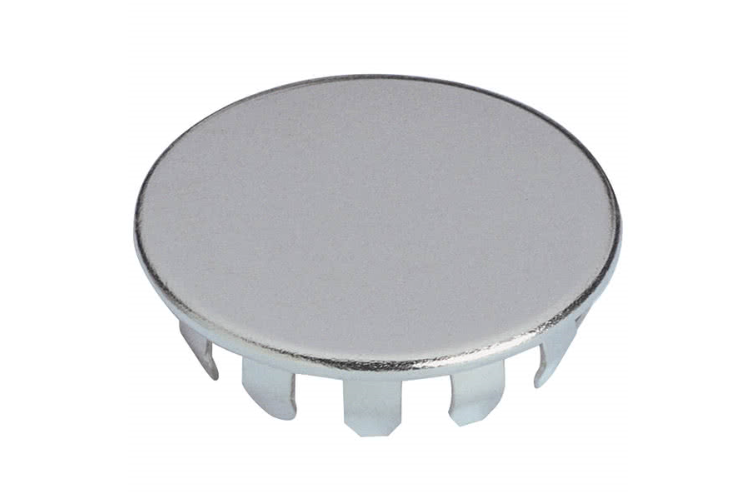

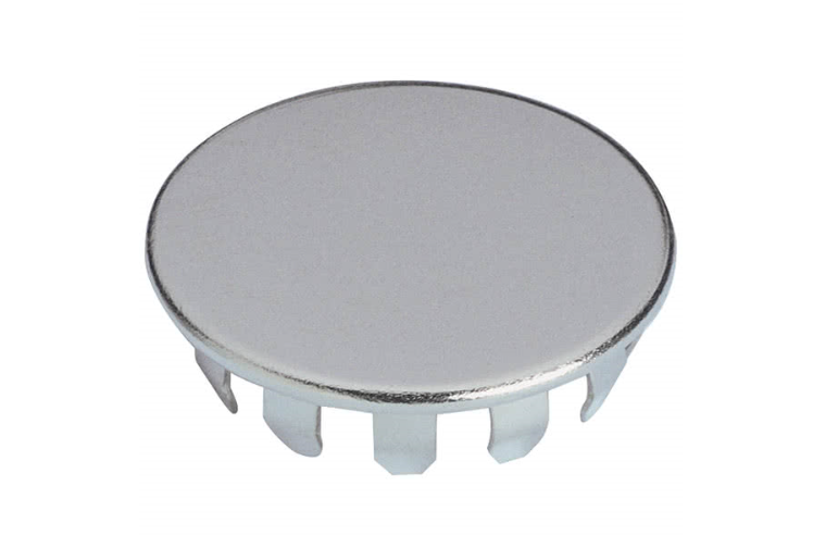

If you do it right it will drop you to your knees! :confused: I found out that I was able to recess it when I went through the process of drying out my deck.
https://forums.sailboatowners.com/index.php?threads/wet-core-repair-without-major-surgery.187846/ When I removed the traveler I found that the one through bolt is just pulling against the fiberglass head liner and that there is about ½” of air-space between the head liner and the actual composite deck. I ended up cutting a 1”ø hole through the head liner and used a fender washer, and two flat washers with a nyloc nut to the underside of the deck. I then covered the 1”ø hole with a chrome hole plug. The end result looks very Skookum and now I do not worry about adding and extra hole in my head.
