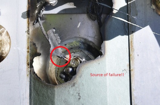

If you look at the photo I just uploaded, the circle looks like it was the source of initial failure.
The terminal, caused by corrosion.
The evidence is the circular burn pattern of the cardboard. The burn started there, and worked it way upward.
Interesting observation. What I do not understand is there are 3 pieces of black wire. Each one terminated in a crimped ring terminal. All thermally separated from each other, the terminated ends of the wires are maybe inch apart. All three black wires melted within seconds of each other. The white wire that is connected to the opposite side of the heating element to where you believe the fire started did not melt. It should be carrying the same current as the black wires but it does not melt, so the white wire and its terminals do not have high resistance I assume.
I'm really not trying to give you a hard time, just trying to understand what happened and if there is anything I can do to my new heater to reduce the chance this might happen again. I did check how tight all the terminals were on the new tank. As a matter of fact they were all tight on the old tank, I had to remove them to send the components into Seaward for their laboratory analysis of the reason this happened.
If that terminal you identified was corroded, had high resistance, and it started melting the black wire attached to the heating element, so then once that first black wire melted back to the thermostat why would the second piece of black wire attached to the other side of the thermostat melt ? Then the second piece of black wire melts back to the high temp reset and an inch away the third piece black wire starts to melt ?

It think the terminal started things (circular burn theory), but the whole bottom of the cardboard caught fire, so it's feasible that the wires on the right burned from close proximity of the cardboard. There wasn't very much "fuel" for the fire, just the cardboard and wires, so it probably burned for about a minute.
Odd how the circuit breaker didn't blow with wires burning...
