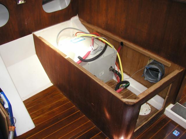

my heat pump is mounted under the aft dinette seat. The raw water cooling pump and strainer are mounted there with it. Below is a pic of the installation after the raw water pump was replaced, but before the water heater replacement.
The unit is a King Air 12,000 BTU that keeps the boat comfortable in the high heat and humidity on the Cheasapeake in July and August.

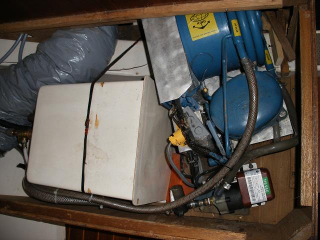

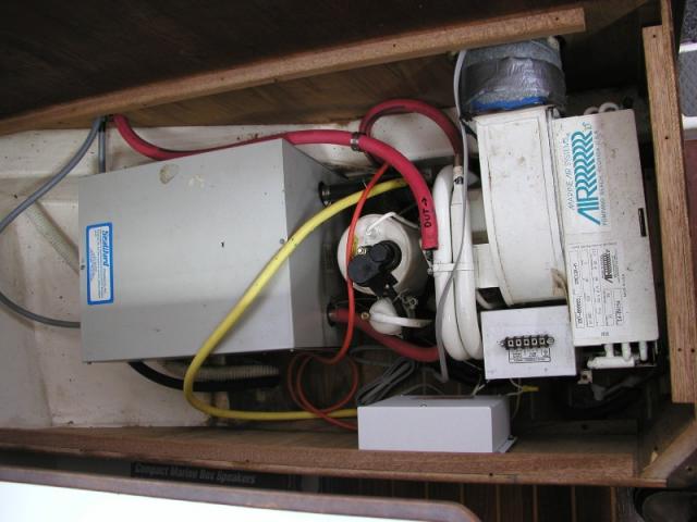

maybe this picture will help you visualize the AC installation under the aft dinette seat. It's a 12k BTU King Air unit. The white box is the old water heater. The pump in the lower right is the raw water pump for the AC unit--the blue thing in the right side of the picture. The hoses across the bottom of the picture lead to a thru-hull for the AC raw water to the right of and hidden by the water heater. The discharge is also on the starboard hull side in this same area, about a foot above the water line. The gray hose in the upper left is the ductwork leading to the main cabin's upper shelf discharge and T'd to feed the v-berth.
The installation of the AC unit by a PO isn't a very clean one, but I haven't been ambitious enough to take everything apart and redo it so it fits better. It was cut into the back of the seat bulkhead, and the lowest map tube was removed to accomodate it. It probably should be turned 180 to have the return air repositioned to draw better. As it is, it does work very well.
Of note, I can have either the AC or the water heater running on shore power at any given time. Trying to run both on the 30 amp service will pop the breaker. Everything else works fine with either one running. If you really want both at the same time, a dedicated shore power link to one or the other is probably the best way to go.
