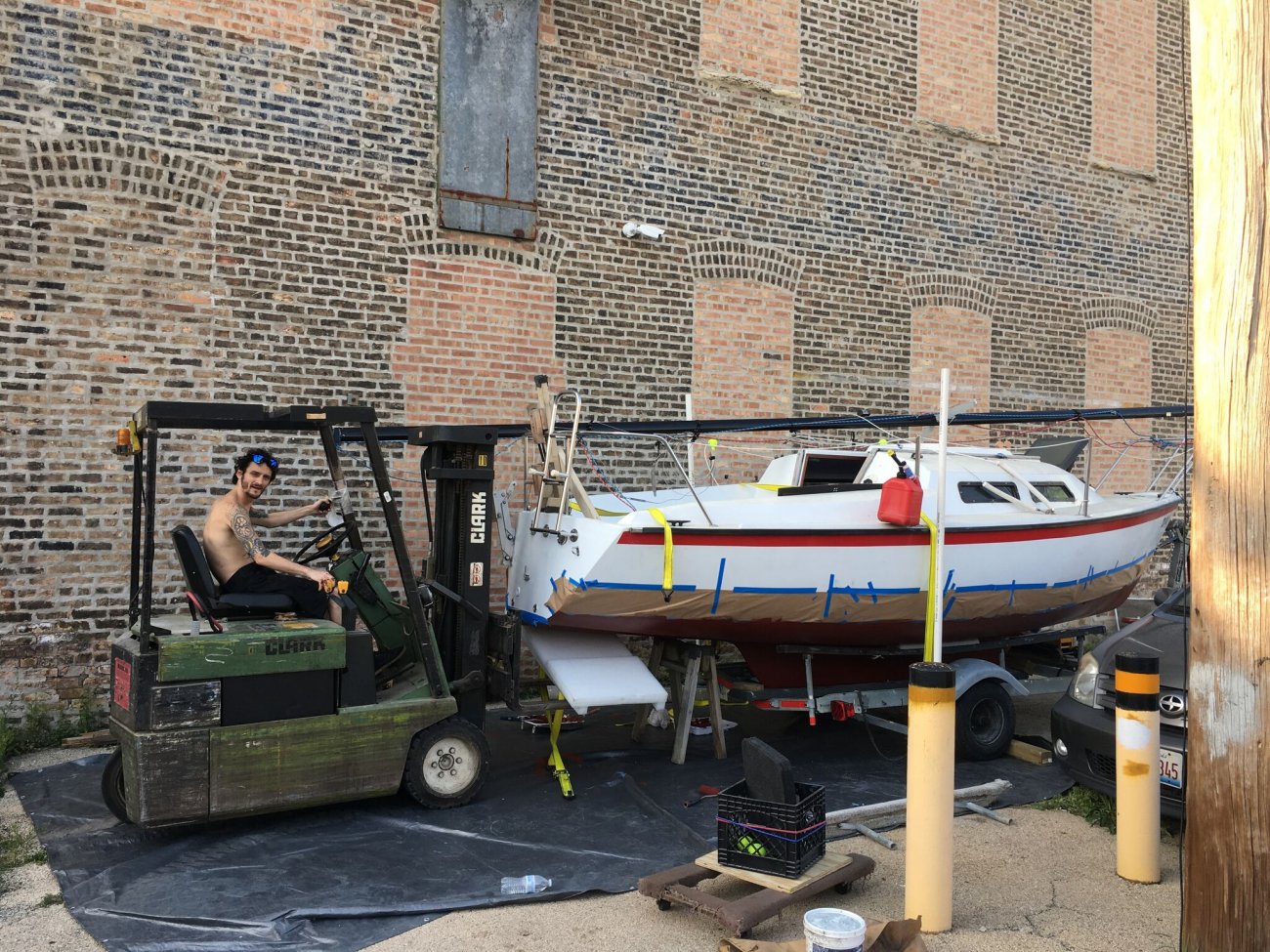

+1 for floor jacks. I would toss a board on the trailer, then the jack, then another board between the jack and the hull. Worked for the front half. Then we resorted to a fork lift for the back half

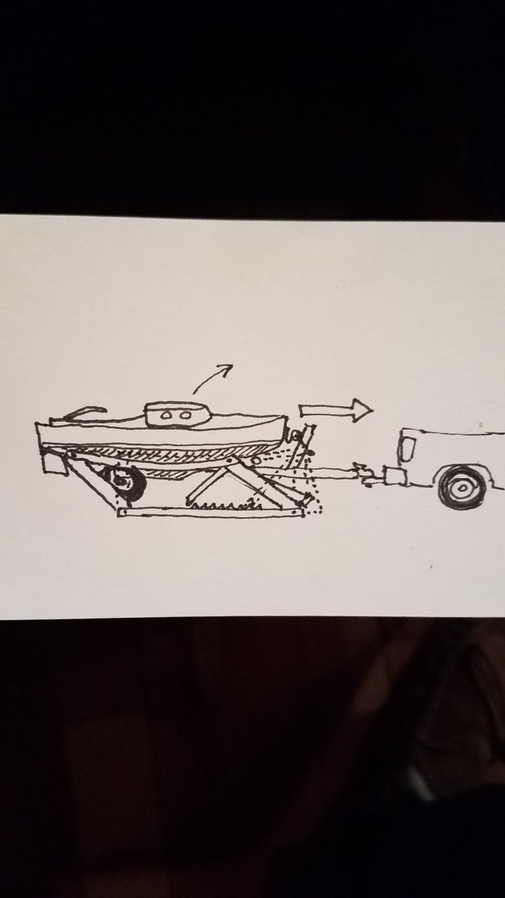

You could make a set of ways out of hinged two bys with a diagonal brace that drags across a row of teeth. This is hard to describe without a picture, but I see it clearly in my head. The frames collapse in parallelograms and open to a rectangle. The diagonal brace is attached by a swivel at the top corner and lays along the toothed track at the bottom. After securing the upper bunks against the hull, pull the boat and trailer ahead with your tow vehicle, thus causing the collapsed parallelogram to open up and lift the boat off the trailer. Easy peasy!:biggrin:
Here, I did a quick sketch.
voilà! Boat off the trailer.
-Will (Dragonfly)

I love Will's idea. I think the biggest challenge is keeping that lift from dragging on the ground while 2000+ lbs of boat is being pulled both forward and up at the same time
Metal pegs into the ground would solve that.
I'd make the system with metal though. easy to fabricate with simple tools.

You both think the way I do. You should be afraid. Be VERY afraid.
Actually, the more the boat comes off the trailer, the less likely the system will drag. But you have to get it started.

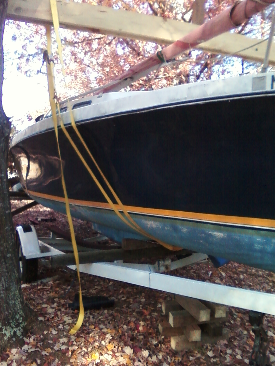

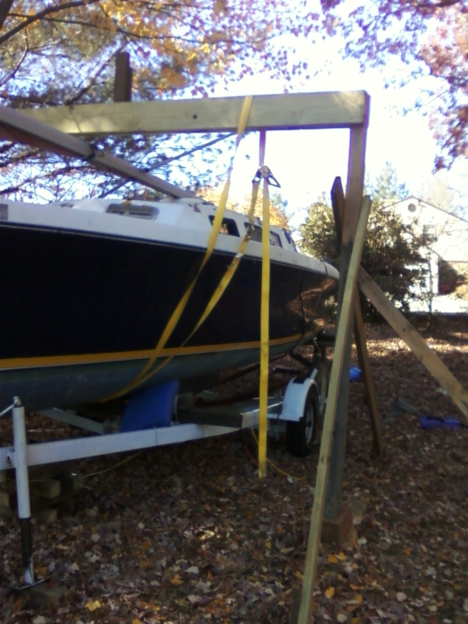

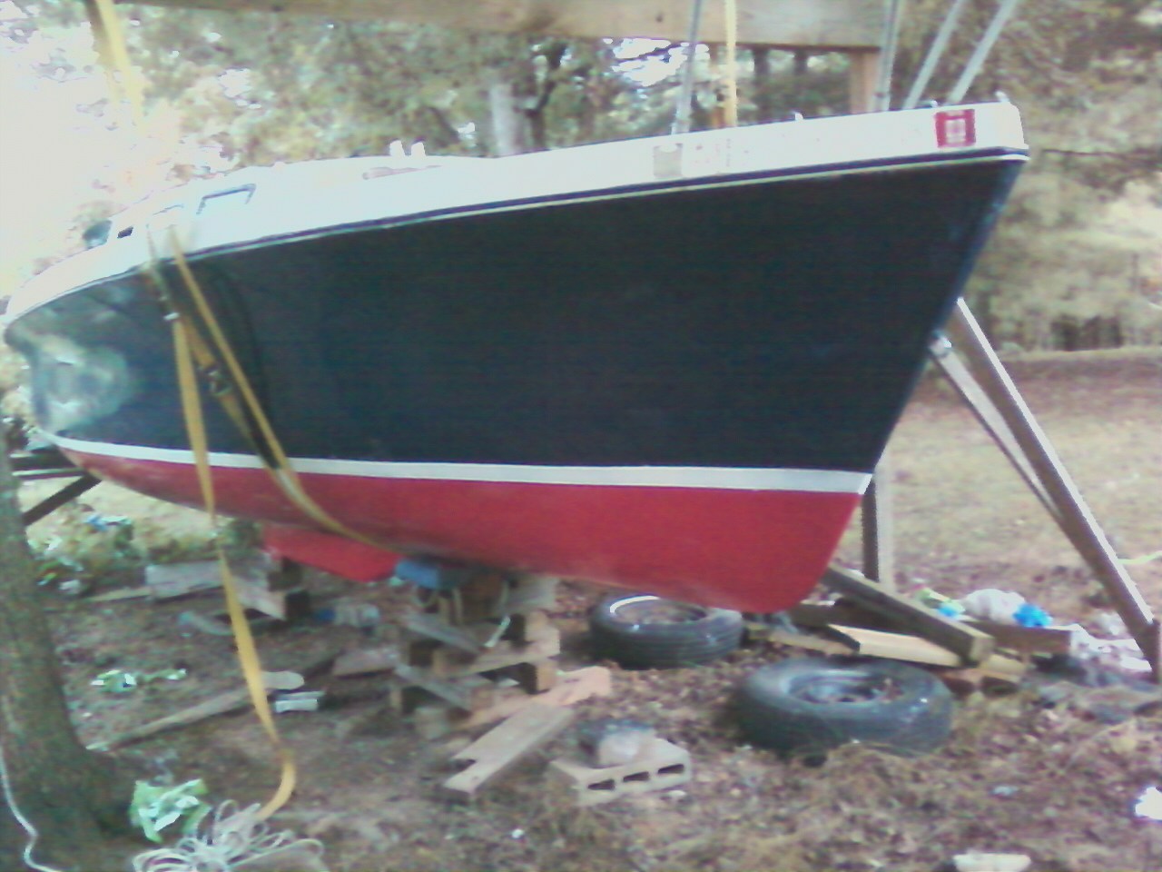

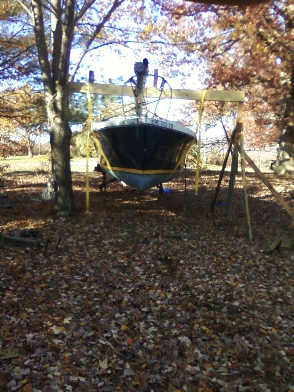

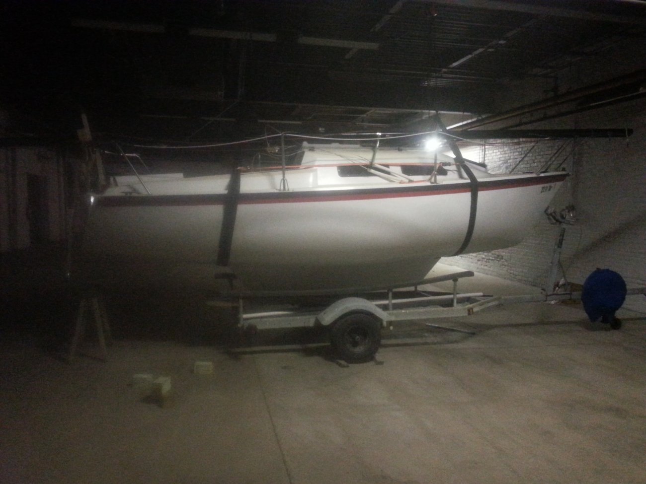

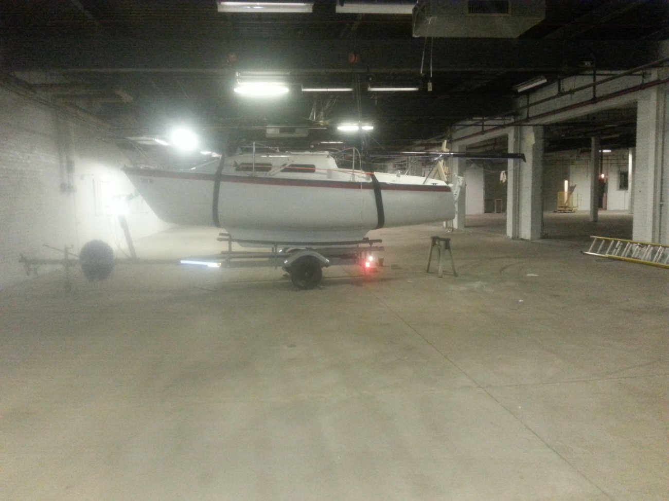

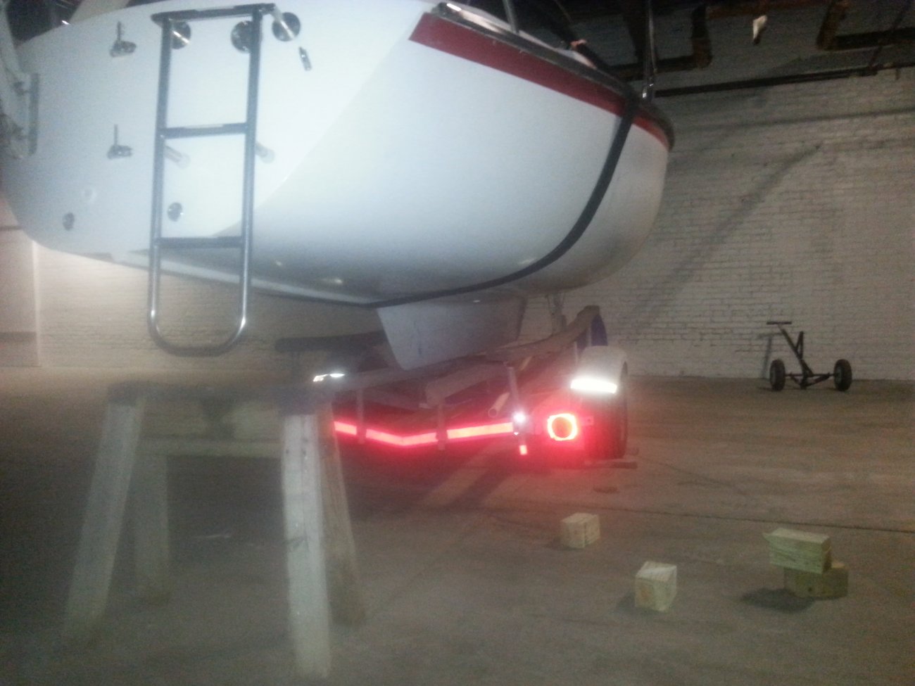

I rent part of a shared warehouse that is divided up into smaller units. For many months there was 100k sqft of unused space. When I dropped my centerboard for repair I pulled the boat through an overhead door that had only a half inch of clearance on either side to get to a part of the building that had steel roof beams. I ordered two large lifting straps for a very reasonable price (can provide link if anyone would like) and used a bunch of round slings, chain and hardware to connect it all together. Two manual winches and an on deck human provided lifting power. I also had two ratchet straps to prevent the slings from sliding forward or aft. I would highly recommend using some sort of beam so your boat doesnt get pinched as its lifted in the air. I had spider cracks in the cabin afterwards. It was a bit nerve racking having a boat swaying back and forth while I was laying under it
