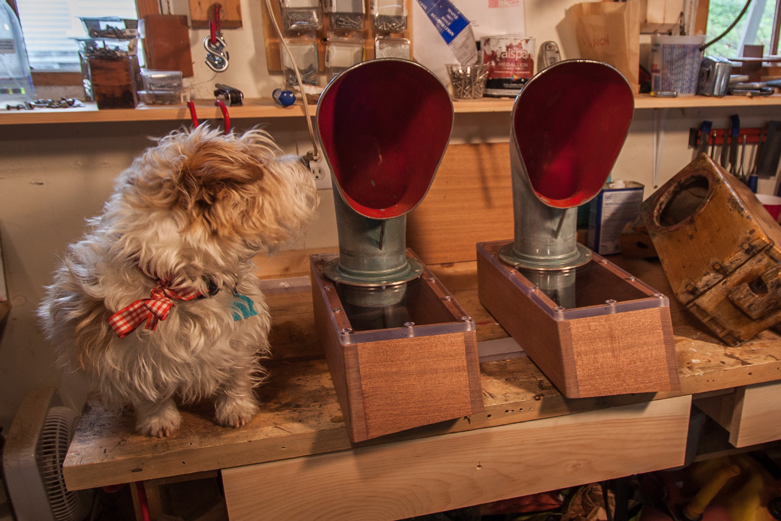

Today was another rainy day on the coast of Maine; I put it to good use cutting and fitting the Lexan tops...
The Lexan front edges were cut to 20 degrees to match the boxes. Once a good fit on the front was had, the Lexan was cut 1/8" oversized, to overhang the other 3 edges.
Then: Clamp oversized piece precisely, and drill holes for screws + countersink. Fasten Lexan (dry), to boxes.
Once secured to box, trim the 1/8" off the 3 overhanging edges with a router and bottom roller trim bit.
Finish: Add a slight round over profile to the crisp edge (won't easily snag lines), hand shape the 20 degree.

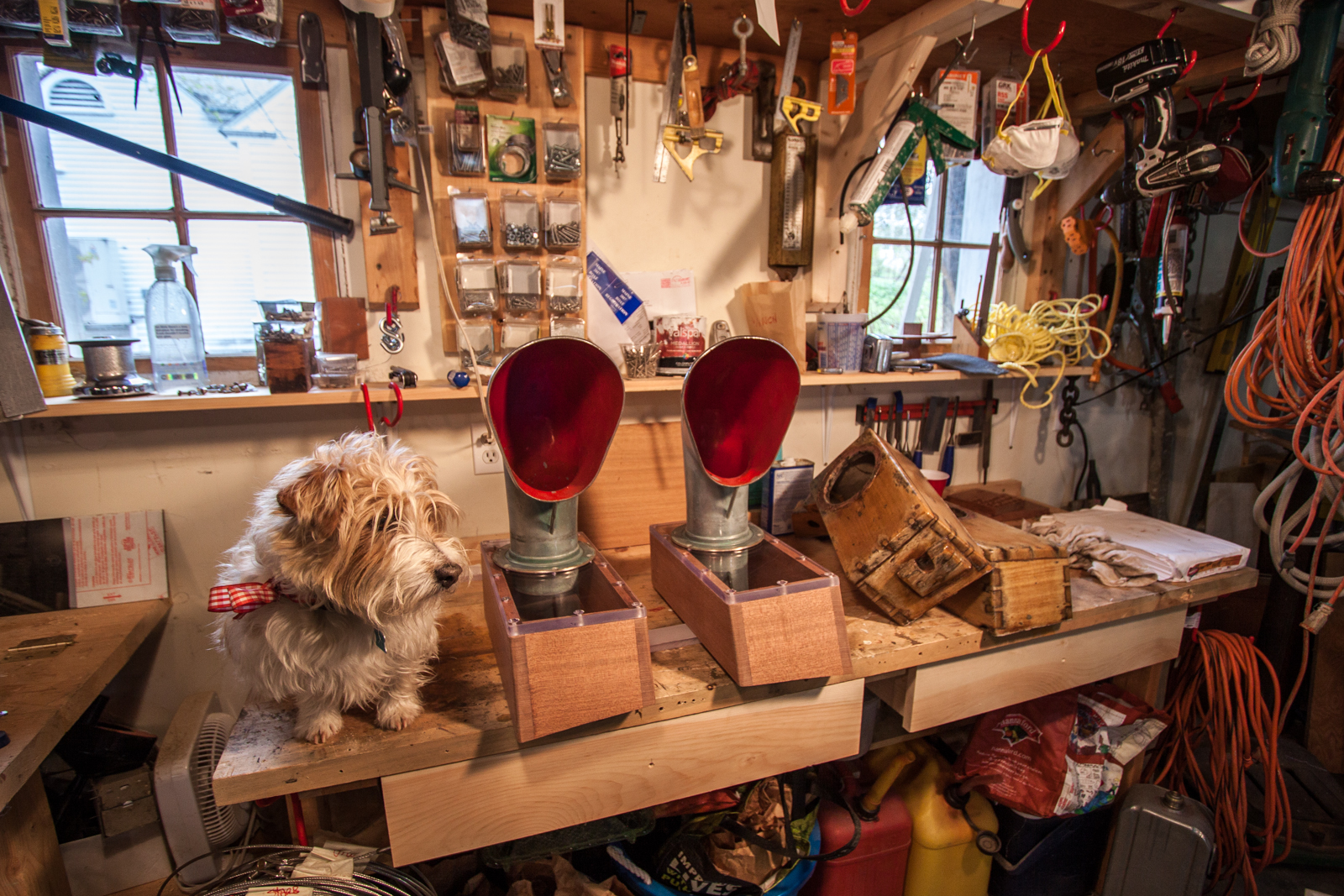

Done. Now they're disassembled, for easy finishing. Once finished, the tops will be - bedded/ secured. I previously fine tuned the fit on the boat - check.
Here's a close up. I picked up the 1/2" Lexan from the local glass store (scraps, good deal).
The nickel plating is wearing off the 56 year old cowls and trim rings. I'll buff them up a little but by the time Xmas has a new owner, the cowls will probably be all green.
And the dog is pointing out the obvious: I need to spray the throats red, again.

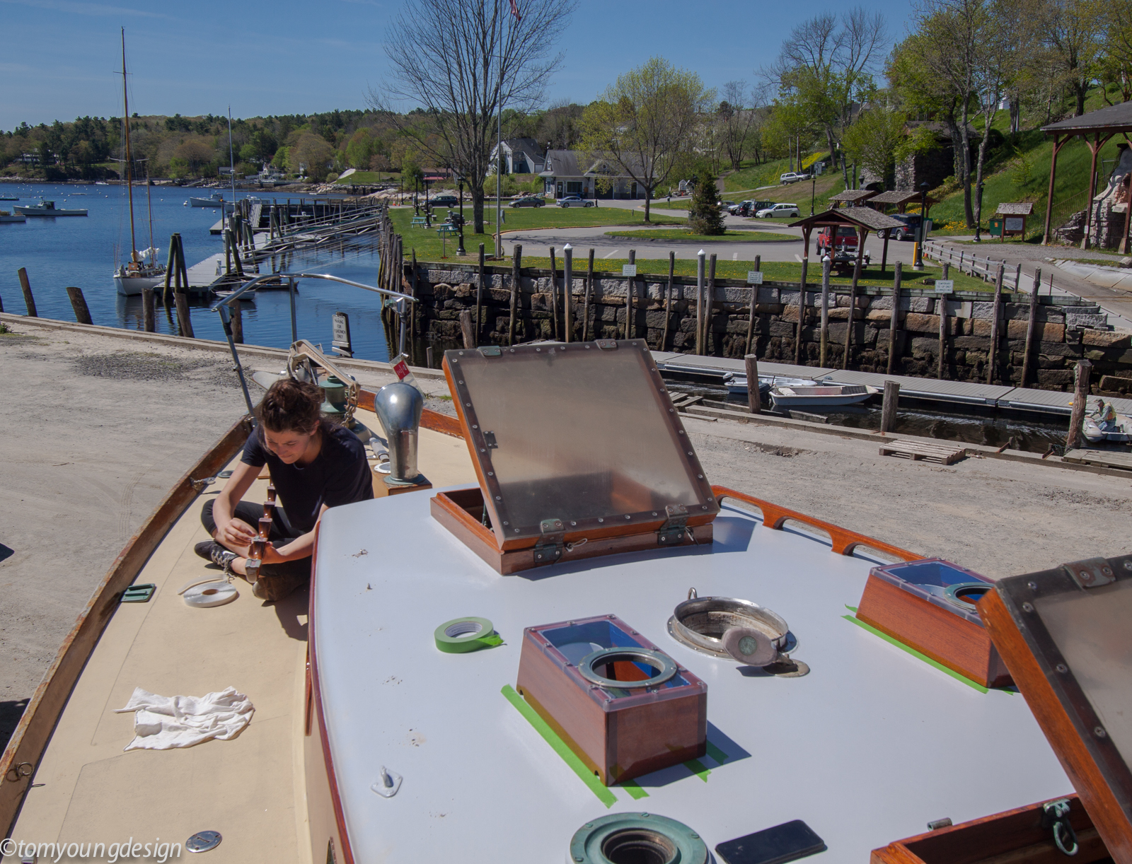

I had the best help, my daughter, to install them this weekend. With the old boxes off, it was a good time to paint the cabin top. I took the handrails off too as I built and installed those a few years ago, to be easily removable. It was a breeze to put a few coats of varnish on them, sitting on a saw horse.
I'm trying my first roll of Butyl tape thanks to Mainesails advice. Those handrails are the perfect situation. I previously installed them with Boatlife Caulk which is messy.
Here's Mary Jane putting the butyl tape on the feet of the handrails.
With MJ above decks and me below with drivers and fasteners, the freshly varnished handrails went back on easily.

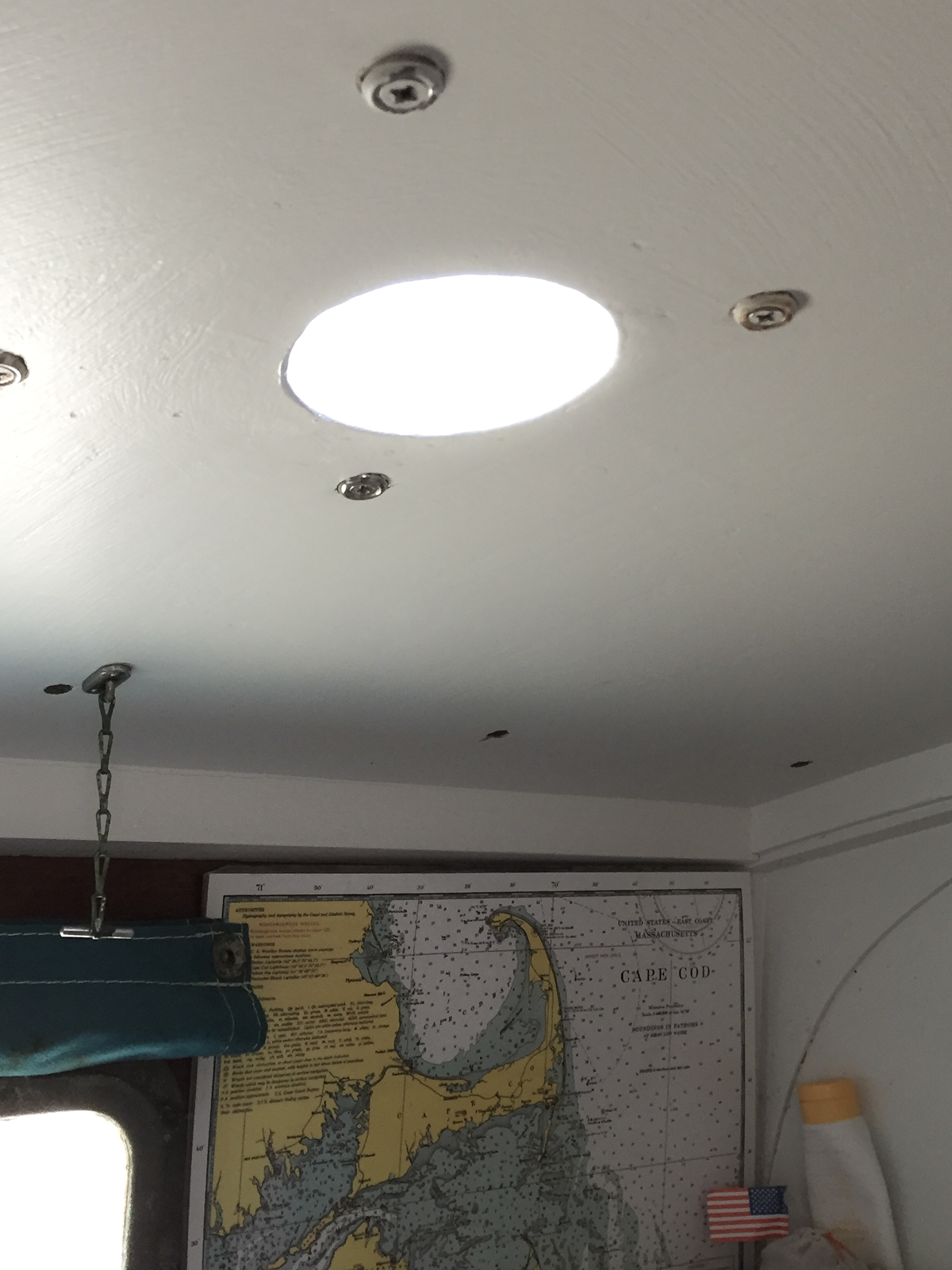

Butyl tape on the dorade boxes as well and fastened from below the boat is again weather tight. The deck holes, that are the standpipes for the ventilators, used to be black holes below. Now the holes, as well as supplying a constant flow of fresh air, are lights in the ceiling. That extra light will be appreciated.

Small detail, but here's the black hole now a deck light.

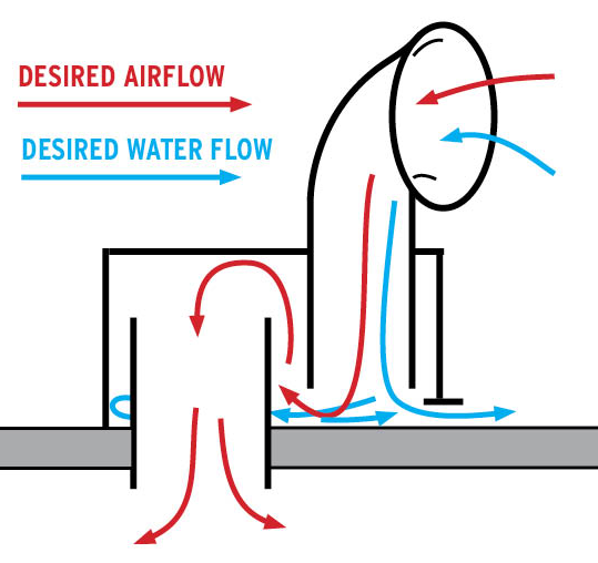

Painting the throats or interior of cowls red to cut light, may have been the reason - pre dorade boxes - when cowls opened directly below decks.
But with a dorade box, light - or no light - can't transmit through the cowls to the deck pipe. The design that prevents water from entering does the same to light. You have to be open to light directly above the standpipes.
