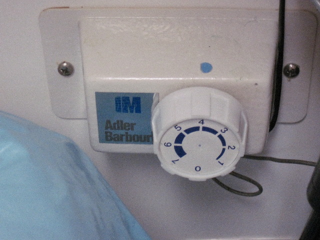

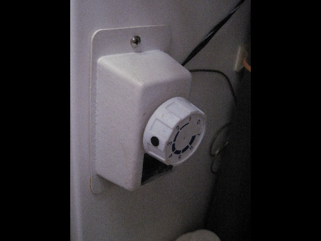

Anyway, in the refrigerator and freezer compartments I have a thermostat control that is a rectangular box with a large knob mounted on it for adjustment. This is an Adler-Barbour unit.
My problem has always been that this thermostat and knob is mounted in a spot that is easy to hit when getting food in or out of the box. So every time I think I might have nudged the control, I make a point to check it. Unfortunately I am the only one that checks, so if someone else unknowingly changes the setting, the refrigerator now either gets warmer or colder.

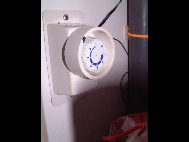

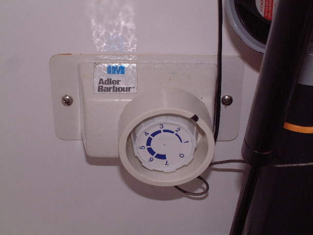

The solution was simple. I measured the diameter and height of the knob and obtained a short piece of PVC piping from my local friendly hardware store and cut two rings of the PVC pipe and glued those rings around the knob. Now the adjustment can still be made, but the ring prevents inadvertent changing of the setting. See the before and after pix below.

What glue did you use?
Standard combination all-plastic PVC/ABS/CPVC glue. Hold it in place for a minute or so. I seemed to detect that my rings slipped down a little so I probably didn't hold it long enough.

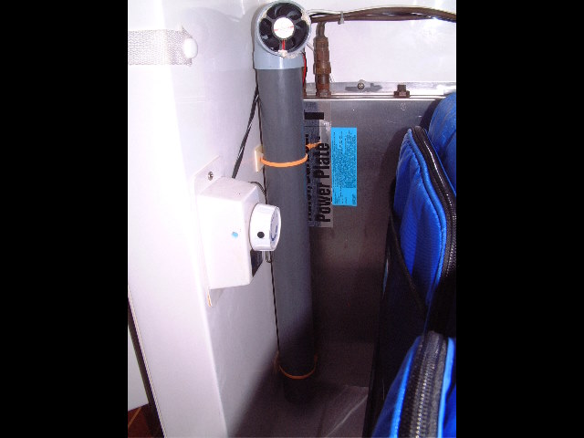

I improved on that idea with a vertical tube and a 2" 12V computer fan. I wired this in to the compressor circuit so that anytime the refrigerator was powered on the fan would run 24/7. The additional advantage of this is that it picks up cold air at the bottom of the refrigerator and blows it across to the opposite corner over the top of the food. It also can't get blocked by food items that is near it on the shelf like the small battery fan.
I also have one in my freezer compartment.
This year since I had recharged my compressors and I was keeping track of performance fairly closely, I did put in a wired thermometer to the refrigerator and put the sensor in the air flow of the fan. I would really like to get a double wireless readout for both the refrigerator and the freezer. Now hat I know it works for you I may do this next year.
The picture below shows the fan I built and installed about five years ago. That was before the recent addition of my thermostat rings.

For those of you that want to add the rings to the Adler/Barbour thermostat, you need 2" PVC pipe and the rings are 3/4" thick.
I have some spare material and I would be happy to cut and send 1 or 2 rings to you. Just ask. It's a snap when you have the material and a good chop saw. I have enough material for about 8-9 rings.
